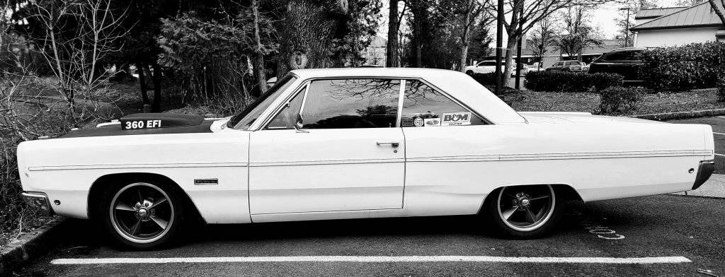

When you are running your A/C you are pulling heat from the condenser thus bumping up your engine temp, especially while idling in stop and go traffic, which is more the norm these days in metro areas. 200 degrees is really not that bad in traffic, on the open road it's probably closer to 190 or 185. Newer cars run about 200-210 degrees because it burns fuel more efficiently. Sorry to hear your bad back prevents you from enjoying your ride. That is a good looking formal roof Fury III.
