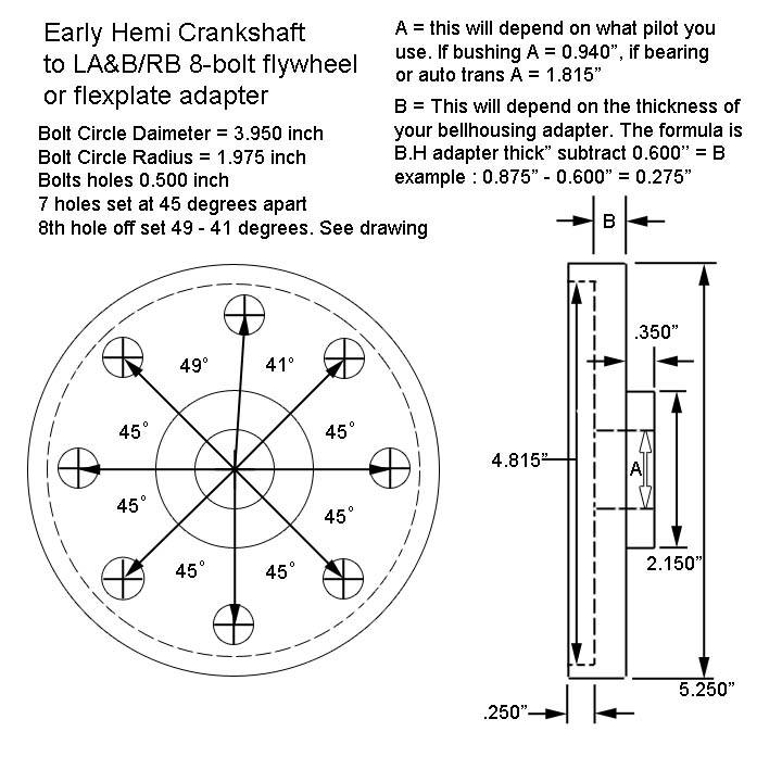

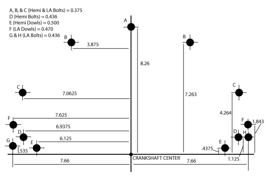

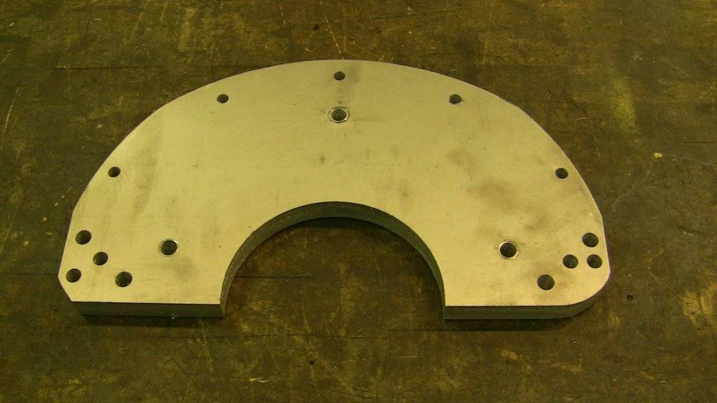

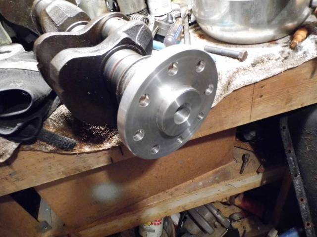

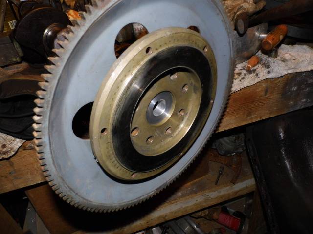

My experience is the industrial or I engine blocks are the same as the car. If it is a 331 it will probably have an extended bell housing built into the block. If it is a 354 or 392 it will not have. All gen 1 hemi's have the same trans bolt pattern and 4 of the 6 holes line up with small block Mopar. You can easily get an adapter to bolt to a Mopar manual or automatic trans for less than $500. I have one on the shelf now that I plan to use with a 270 Dodge Hemi going into a Model A Ford. The only opposite rotating engines I have seen are for boats with twin engines but I could be wrong. The tell tail for the revers rotation is it will not have a timing chain it will be gear driven.
Pic below is the specs for bold measurements from HEMI to LA engine
Links to the HAMB form
Hemi ID
HEMI Tech- Identification

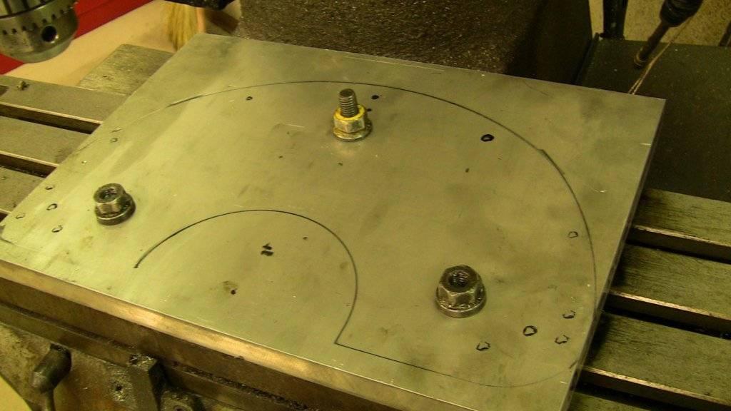

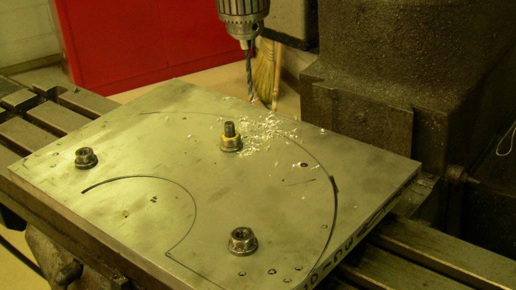

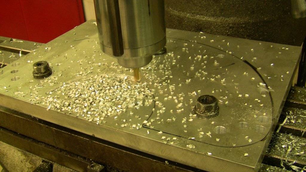

Here is my link to the adapter I made for mine
Early Hemi to LA Mopar Bellhousing Adapter
