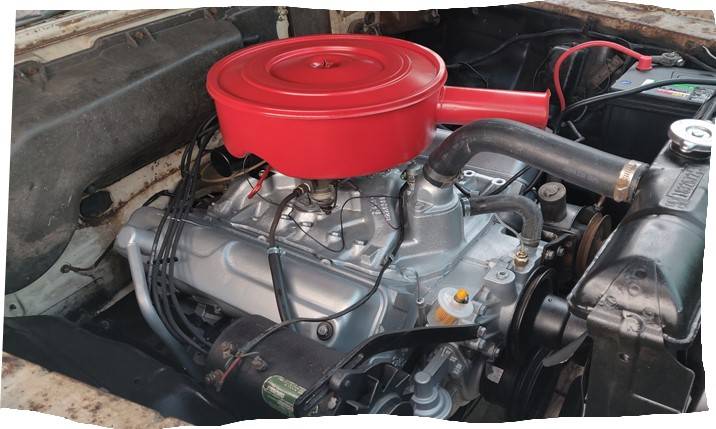

Will have to check some more to see. There was just fuel pooling on both sides of the carb in the intake valleys. The carb is a throttle pull style. The engine is the stock size 326 Red Ram V8. There is a wing nut to remove the air cleaner lid for the air filter access. The actual air cleaner assembly is held on by a clamp around the carb under the housing.

Thanks for those confirmations. Just a normal Poly A motor family item, it appears.
