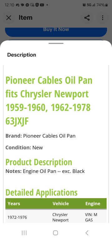

I have a 1961 Newport with the 361b engine that I am trying to find a replacement oil pan for. I have found several places that list 1959-60 1962-78.
Can someone please explain why the 61 is skipped? What is special about this year that makes it the blacksheep? Wouldn't the oil pan be the same on all the big block engines? Or do I need to get a pan and pickup from a different year?

Here's what you do... Go to this page; Parts Manuals – MyMopar and download the "interchange manual" that's listed. Open it and go to page 71 for the oil pan listings. As I see it, the '58 to '64 big block pans interchange, but you look at it yourself.
While you are there, download the parts manual for 1961 and I'll suggest that you get 1960 and 1962 also. Sometimes that year or so either way gives some insight to what you need. They also have the Factory Service Manual for your car. Service Manuals – MyMopar
I know we are supposed to trust aftermarket vendors' parts listings, but sometimes THEY are going on "hearsay evidence" themselves. Nor do they have the capabilities of researching their listings for accuracy, typically. So best for them to delete something rather than say it will work and it doesn't, as a default mode.
Which is where the "Interchange Manual" comes into play. The old Hollander manuals were used by salvage yards to know what would fit, what would not fit, or what modifications might be needed for one part to fit a different vehicle.
