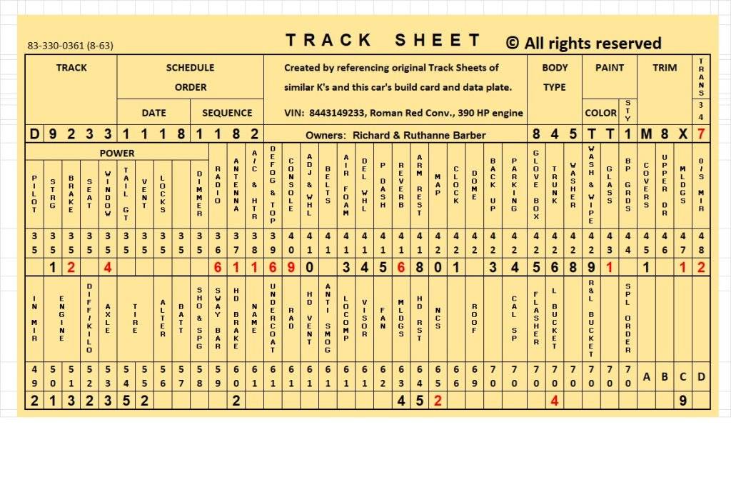

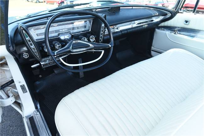

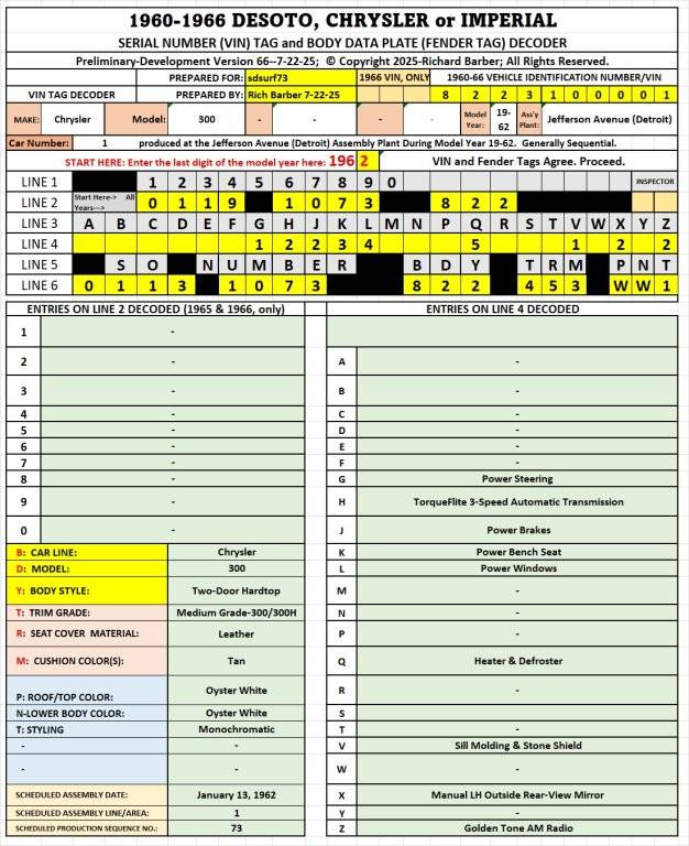

Hi, Old Surfer Dude! Welcome to these pages, Nicely loaded little coupe. Let me know if my decoder report matches reality. Please note the similarity of Lines 1 and 6. The first three blocks must be the same, but you show SO = 0119 in one place and 0113 in another. NBD as it only affects the Scheduled assembly date by the six days. I fudged in a typical VIN prefix to complete the report. I'm guessing it might be about 8223166000. I often suggest my clients to search for a Production Broadcast sheet--sometimes tucked in behind the back seat springs. Worth the effort to pull the seats and search. It will tell more about chassis items such as engine, diff ratio, tires, SureGrip, AutoPilot & etc.
Thank you!!! I didn't know about the leather. Maybe they were redone but they seem vinyl to me
Do you know what the carpet color would be?
I reviewed my decoder and TRM code 453 is definitely tan leather. Are the seats still tan? I have no information on carpet color, but I would hazard an opinion that the carpet might have been tan, also. I have many pix of 300's & 300H's All H's have console and most have tan carpet. 300 Sports tend to have black carpet unless they have the optional console--and then the tan carpet. I will pose the question to several resources and let you know the answers, if any. Attached is a pic of a white Sport coupe with tan (leather?) seats, no console and black carpet.

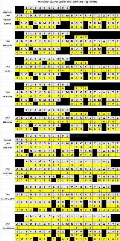

Ignore the spreadsheet--accidentally inserted and could not delete it.

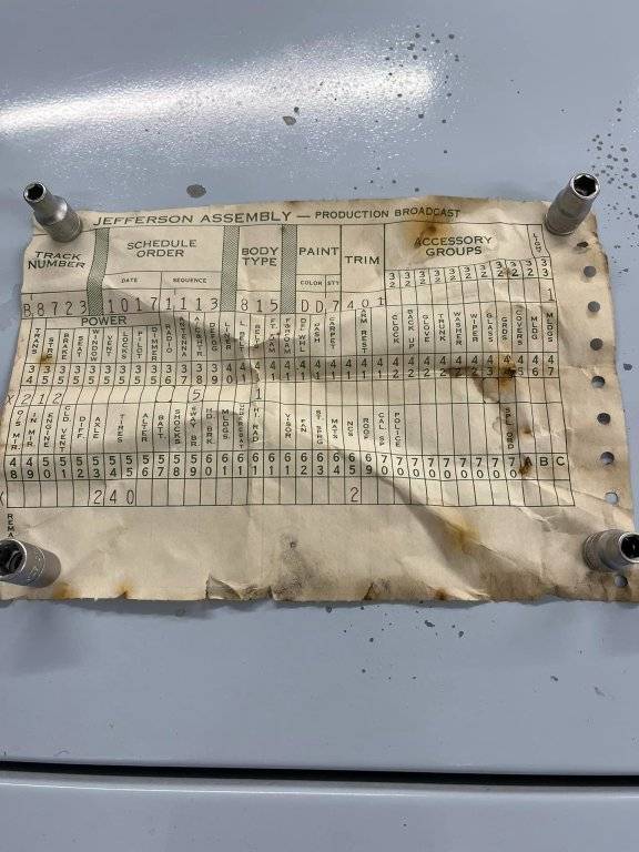

@Torky not sure if you saw in my other thread but I found a track sheet for my '64 NYer on the rear seat back.
Thanks!
That is the seat set up I have. Seats and exterior color on a non-letter 300. So black carpet?
Thanks!
Georges77: I'm sorry. I have so many requests in the que that they tend to run together. Data I have in your name is for a red '64 NY 4DSedan. The track sheet is for a white '64 NY 4DHT. Have I lost track of your car(s)? Mixups of Track Sheets are common. Both of these cars have the same TRM code so one back sheet pretty much looks like another. The SO dates are just one day apart and the VIN's are only 28 apart. To add to the confusion, the middle and bottom lines of the Track Sheet are both offset one space to the right. The three digit codes need to be shifted by one space to make any sense, so the paper must have got off of the tractor perforations after printing the top printed line-which appears OK. Hinky, to say the least. If you want, I will make you a 1964 Track Sheet for your car--it may not be perfect but would make a good addition to the hinky TS in your provenance binder! What else is new?
You know I thought it didn't look right lol!
If you had a chance to sometime that would be wonderful, but really I just wanted to post what I found and say thanks for telling me where it was! Appreciate your work
