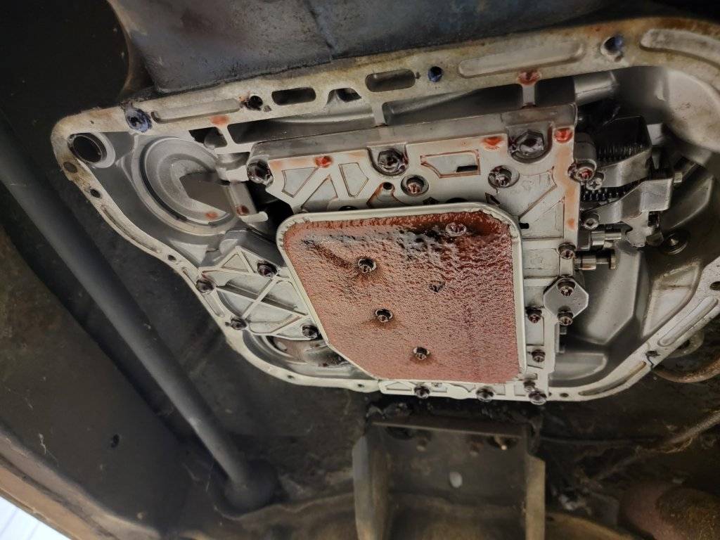

1962 Imperial, going through it to get it ready for the road. Dropped the tranny pan and it has a normal cloth type filter in it. Trying to find one listed for it seems impossible.

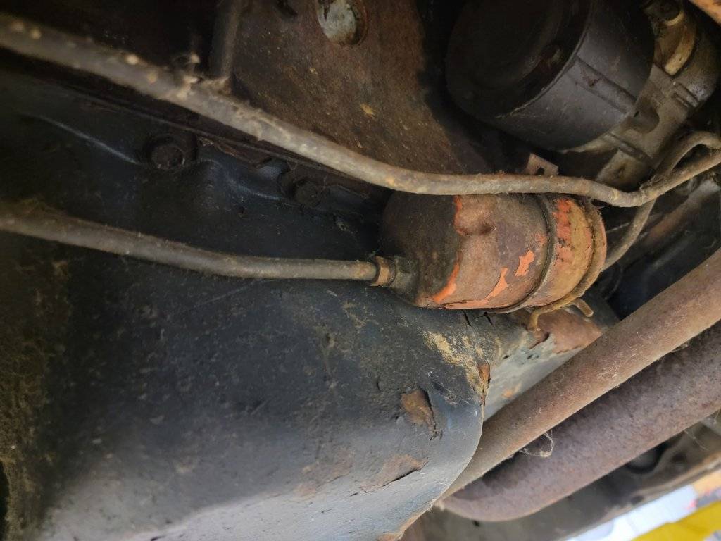

After some reading it seems they originally came with just a filter screen and had an inline filter on the cooler line. I do have a filter on the cooler.
So what filter fits on the transmission so I can get one, and gasket?

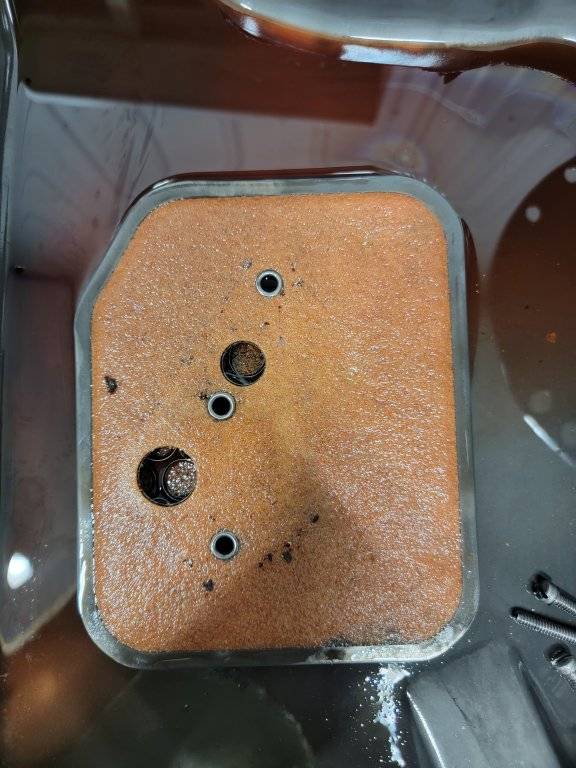

They don't need a gasket, and they do need to have two holes for fluid pickup like the one you show. The 1966 and newer have just one pickup hole, that won't work for your 1962.
I would brush off the dark spots and keep using the filter you have. I like them better than the screens.
Here ya go!
I'm sure they sell good gaskets too. Make sure the bolt holes are flat. Tap them flat with a small headed hammer over a block of wood as needed.

Go to your parts store and tell them you want a WIX 58658 filter. Otherwise they will more than likely give you the wrong filter with one hole. I just dealt with this same issue last week.
