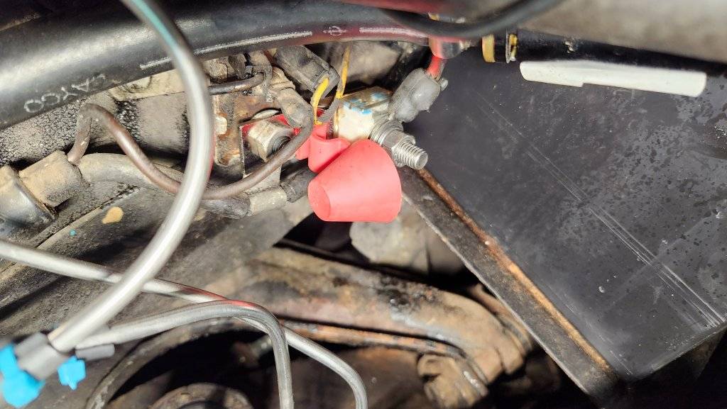

- I'm using marine battery terminal mount fuses, which have the advantage of no added wiring, and bolting right over the alternator and starter relay lugs. (picture below) They also have some pretty heavy-duty capacity.

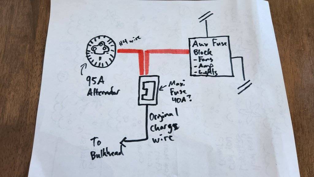

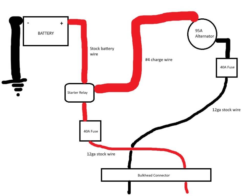

So, I'm proposing adding a #4 charge wire direct from the alternator to the starter relay, per Powermaster's recommendation. I've also ordered a solid state voltage regulator, as the packaging also suggested that would work best with the new alternator.
I'm hoping people here can check my work. This looks suspiciously like the "shunt wire" that @72RoadRunnerGTX debunked with his videos, which I've watched. (Thank you, those were so informative!) However, my understanding with the shunt wire bypass is that the problem is that the fusible link is only at the starter relay, on the "left" side of the circuit, and the shunt allows overloading the "right" side of the circuit without activating the bypass. In this design, both ends of the stock circuit are fused, so that shouldn't be possible? I guess if something shorted, it could pull 40A from each leg, culminating at 80A at the termination - but that should blow a smaller fuse in the interior fuse block first.
I think this might invalidate the ammeter, but I have a modern voltmeter as well so that doesn't concern me.
In this design, the only place high current can travel is between the battery and the alternator (and the starter, but that's irrelevant) right? If this doesn't work, I guess my only options are a full custom harness, or back to the 39A alternator.
Suspiciously? that is the “shunt wire” bypass. While the two added 40-amp fuses should protect the stock under-dash wiring from over-current in the event of a short and it will defeat the ammeter’s accuracy, it will no longer be useful as it was originally designed.
You still need fuse/circuit protection on the shunt wire near the battery to limit battery current in the event of a short on the large shunt wire, an internal alternator short or short at the alternator stud.
If the alternator is not keeping up with loads at idle, not seeing how this will correct that.
BTW, I’ve heard of that same Powermaster support response numerous times, they don’t understand this system or are only concerned with not having to deal with a warranty return.
First of all, thanks for explaining. I've been on internet forums way too long for a flame war - I really want to learn! I watched the videos on your youtube channel, and I feel like I understand so much more.
I'm ok with the ammeter not being accurate. I am NOT ok with fire! I have an aftermarket volt meter that is accurate, so that's good enough for me.
For fuses on the shunt, I could use the second fuse terminal off the alternator with 100A fuse, and add another at the end closest to the battery. That should cover all scenarios you mentioned.
I share your skepticism of the Powermaster response, but I figure it's at least worth a try, if only to strengthen my warranty claim. Shouldn't take more that 10 minutes to install, and immediately obvious if it makes any difference. Given my understanding of electrical current as "volume of water in a pipe" it makes some sense that the stock wires could be a limiting factor.

- Install MBRF terminal fuse block over alternator battery stud
- Connect black, 12ga factory charge wire to one of the fuse block terminals, with 40A fuse (I did need to expand the ring terminal hole from 1/4" to 5/16", so technically I modified the factory harness here, but there's no reason the terminal couldn't still connect to the stock alternator stud in that state.)
- Connect one end of the 4ga charge cable to the other fuse block terminal with 125A fuse
- Route the 4ga cable back to the starter relay in a way that pleases you. I ran mine along the core support.
- Connect the other end of the 4ga charge cable to the free stud on the fuse block terminal you added to the starter relay, using 125A fuse
- CHECK: Use a multimeter to check resistance between the battery stud of the alternator and the stud of the starter relay. 0 Ohms should mean your charging circuit is complete and healthy

MBRF terminal installed on starter relay

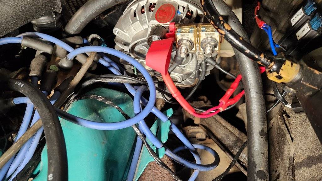

MBRF terminal installed on alternator (4ga charge wire not yet installed)

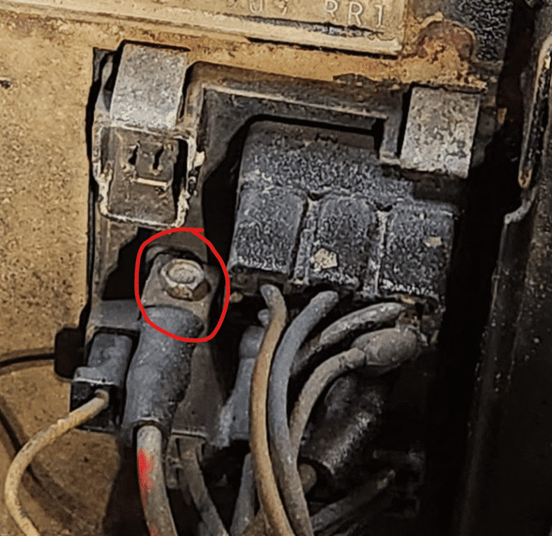

1. Does that MAD article even apply to me? 1963 has the screw-type connectors (picture below), which I've read are superior to the packard/delphi 56 terminals most articles reference. Unfortunately, most articles aren't aimed at early 60s Imperials, but later Chargers, trucks, etc, so information is scarce.
2. I'm ok with bypassing my ammeter. One of my aux gauges is a voltmeter, so I would still have eyes on my charging system.
3. The connections on the back of my ammeter also look very good to me. I did the RTE solid-state volt limiter upgrade on my gauge power last summer, and everything looks remarkably clean.

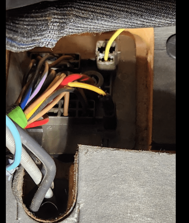

My bulkhead connector, for reference, power terminal circled. I know it looks a bit grungy, someone went crazy with the Ziebart on this car at some point.
And here is the inside, so you can see the general condition:
Do I need to modify my wiring to upgrade my alternator?

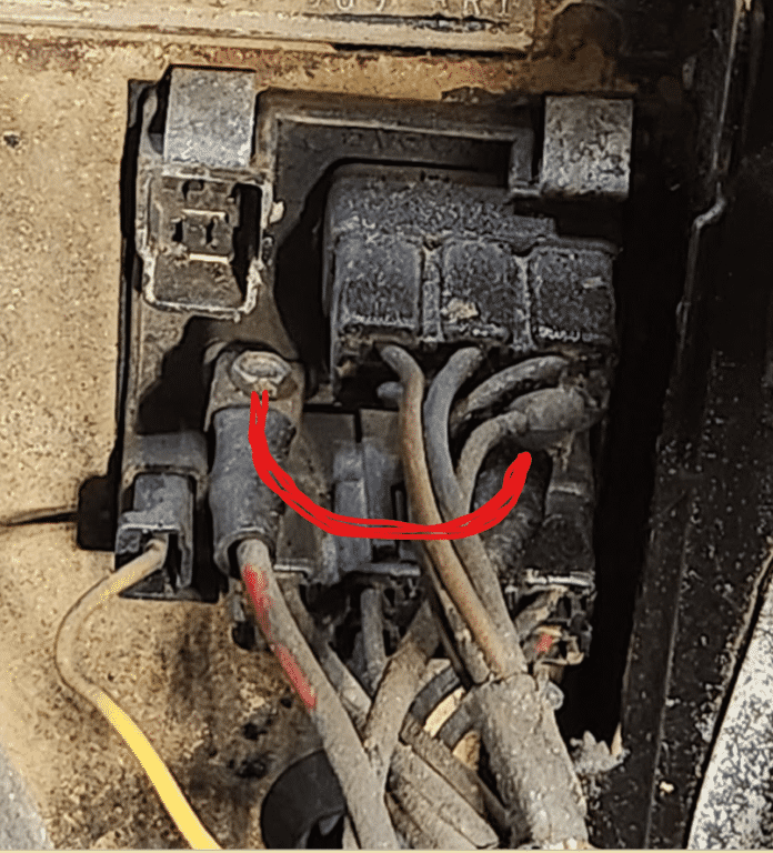

Second question: Instead of a bypass from the alternator to the starter, what if I just made a jumper wire from the red to black terminals, inside the engine bay?
I haven't seen anyone mention this, so maybe it's a bad idea? My thinking is that this would prevent excess current from going into the dash by providing a second pathway to the battery, but it would still be a single pathway, which would preserve the utility of the fusible link at the starter relay? I suppose maybe this does not help if the factory red & black wires aren't up to the task? Or maybe the bulkhead terminals themselves would still overheat?
Here's an example of what I was thinking. (Black terminal is obscured by 6-pin connector above it)
Anyway, really would like some advice here. I'm no electrical engineer.

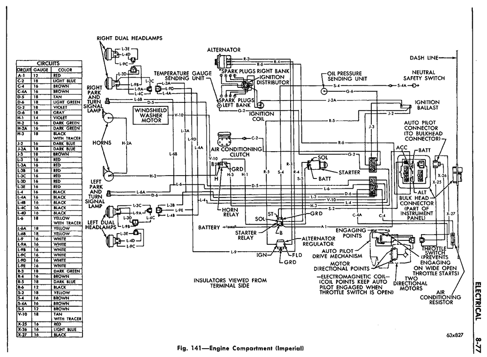

Finally, here's the wiring diagram if it helps anyone:
