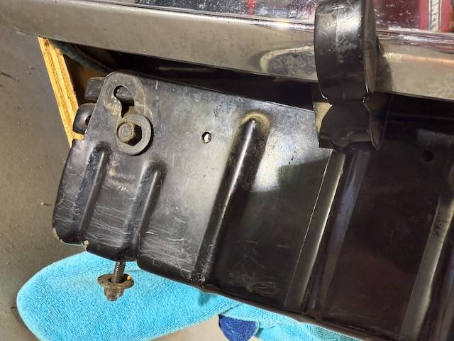

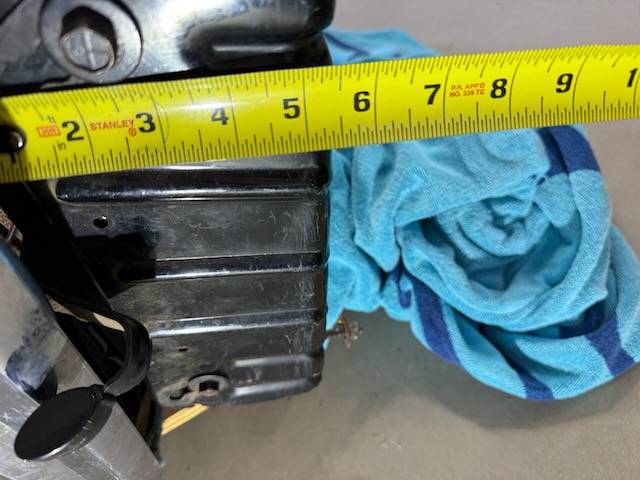

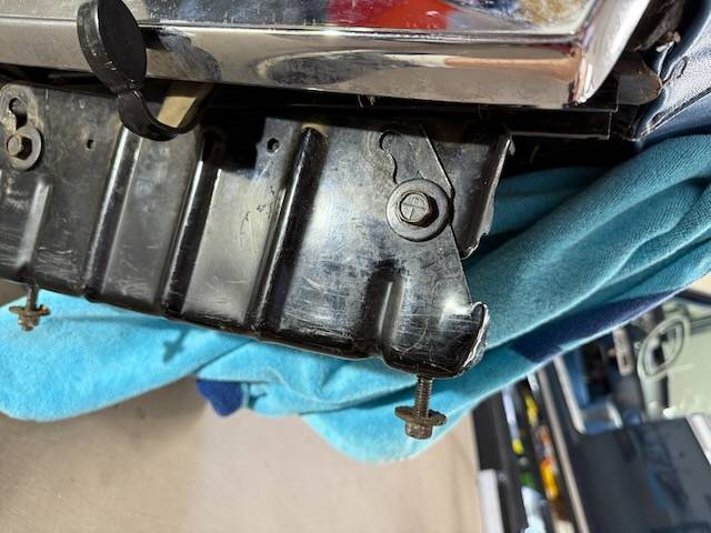

I have asked this before, but does anyone know how to lower the front split seats on a non-power seat on a 64 Chrysler 300 split seat? I have them out and trying to figure out how to lower them. They are set up for a petite lady, which I'm not. I have lowered them as much as I know how by the bolts. Other than drilling 4 new bolt holes to the lowest point, is there another way?

The angled slots the side bolts are in are the limits of the vertical manual adjustment. You might need to find somebody to fabricate a spacer flange of sorts to move the seat tracks rearward (compared to where they new are) so your legs are more straight. Like a 6" rearward movement?

As a fairly big guy myself, I'll suggest that you try leaving the rear down and bring the front up. That angles the seat back a touch which will give you a slightly longer distance to the steering wheel and raises the front of your seat to support the underside of your legs. While it doesn't really drop the rear a lot, the angle makes it feel that way.
This is the way I set up my '65 Barracuda seats that also has the slotted seat mount. I'm 6'2" and most of my height is in my legs with long arms.

I cut the top off the base that has the slots and re-slot the base farther down.
You got about 2 inches to go.
