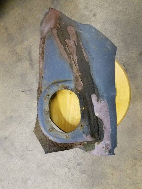

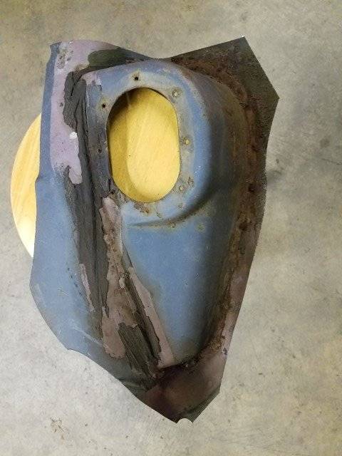

swapping in a 426 wedge motor a833 4spd into my 65 880 rag , got these parts to handle the 4spd
swap . i know the tunnel hole is not right , i'll live with it . using an 413/426 indust block and crank . and going with a 143 t flywheel 11'' clutch an bellhousing .

commando1 , that from a 66 fury , ovaled hole , 65 is round i'm told . guess if its an issue i could make a hole adapter to go round on the shifter boot .
I can't one hundred percent guarantee it, but I'm reasonably sure the 65 Polara used the same one you have.
Just take your console out and check!
You're forgetting my car came with an auto..... I'm the one that bastardized/customized it. Mine's got one from a 64 Sport Fury that didn't fit well and was cobbled in there.

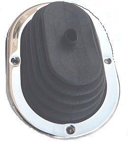

I do know that the cars that had the round shift levers had either this shape hole

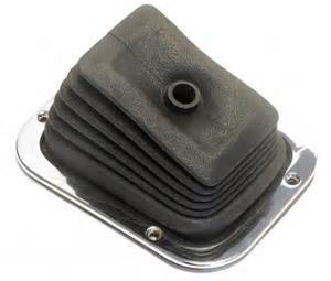

or this this shape hole
Which year got which one, I have never figured out.
65 is square , okay . you guy are the best . 65fury440 is your stock looking ? and is the hump square as well ? well and happy turkey day guys . beings my roommate has a peehen for a pet and i call it 'thanksgiving' all year long . so i'm barby quin' big thick new york steaks with all the trimins' and watching that pretty bird walk around the yard . thanks cool , turkey for a month after ate my cup of tea , lol . all enjoy n be safer then the other guy !
Yup the tunnel is the same as a non 4 speed, the factory hump looks like it was added it later down the assembly line, as there is some tar type sealer tape on it.
