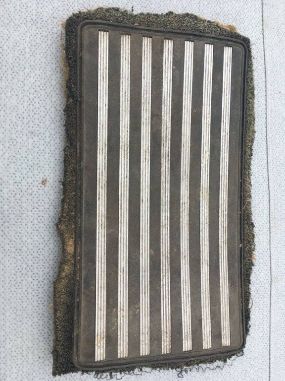

I am looking for this striped style floormat. It was in my 1965 Newport but I have seen it in other similar vintage C.
Anyone recognize it? Model Years/Carlines used? Fronts only or front/back? Availability new today as replacements?
I would rather have originals in good condition.
Thanks for a bounce-back in advance from anyone.

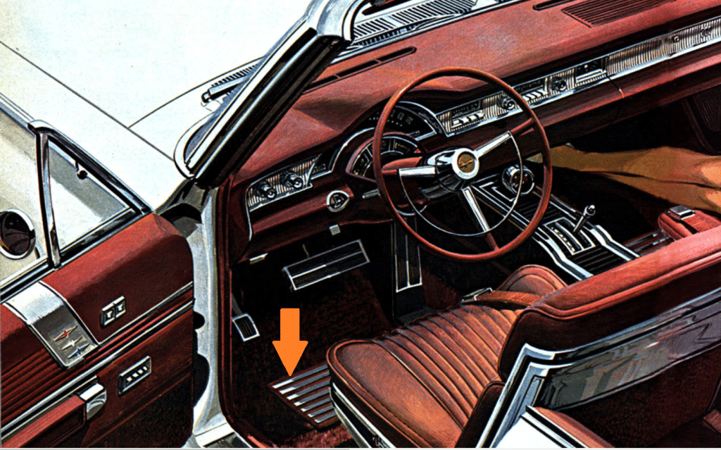

illustration below - mat looks it has shiney stripes - in the 1966 300 brochure from this source: Directory Index: Chrysler_and_Imperial/1966_Chrysler/1966_Chrysler_Brochure

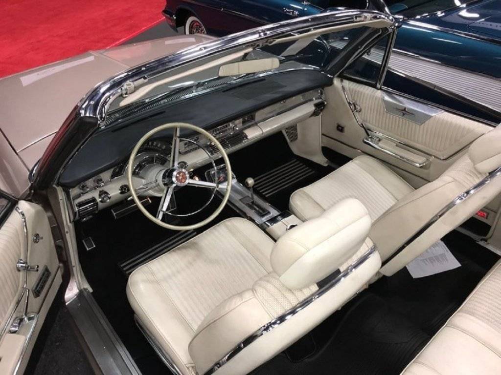

1965 300

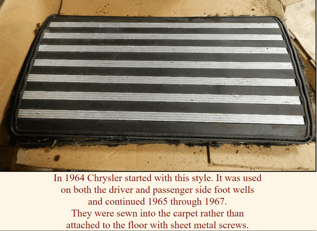

We talked about this one a few years back but it would take me a day to find the thread. It's sewn to the actual carpet pad. I believe @Zymurgy stated he cut his original one out and glued it to his new carpet pad. Fronts only from what I've seen. Theyre definitely in the 65-66 Newport and 300. Not sure about New Yorker or post 66 cars.

Did we conclude, therefore, that one needs the WHOLE carpet (Front sections if two piece) to get the "stripes", or @Zymurgy your supplier (you have a coco mat source recommendation) just did the rectangular section (which you used like a floormat OVER a new carpet)?
original owner of my 65 Newp had sacrificial mats down, but you can see the original carpet still took a beating.
I did NOT know the stripes were integrated into the OEM carpet. first time I ever recall that design was in my 65 Newport. I though it was aftermarket till I kept seeing them in the "survivor" cars and then factory brochures

I should clarify I totally baled on utilizing the rectangle section completely. I had originally planned on having custom carpet mats made and then inserting them in the mats.
Also you are correct they were only located on the front seats. Something to keep in mind the plastic surrounding the metal was the color of the carpet. So in my case it was a yellow gold color, so to replicate the look dying the plastic would be part of this process. Looks like you probably already realized this.
I believe the one shown is still around in a box after my move. It is used and may not be of the quality you are looking for. You must have a few car projects going if you need 8.
I don't want to discourage you from doing this, but part of my reason not to proceed was I wasn't able to restore the metal portion to a level I was happy with. It is embedded into the plastic so I couldn't work on it properly while it was still attached.

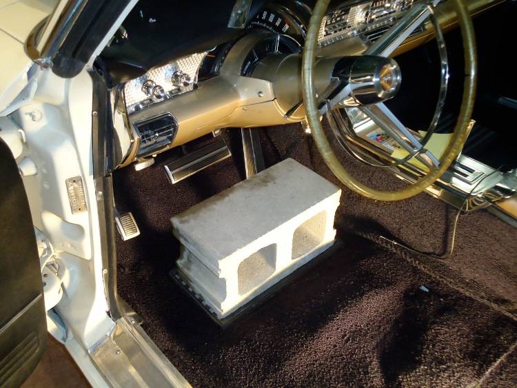

Murray Park and I have been in conversation. He probably has (meaning he has heel mats) what I need for this project. We'll see. My plan is to, as needed, recolor, clean, polish aluminum, etc. and then with contact cement and a cinder-block, attach to three of my slabbies.
we'll see how it goes. thank you to all willing to help and comment.
