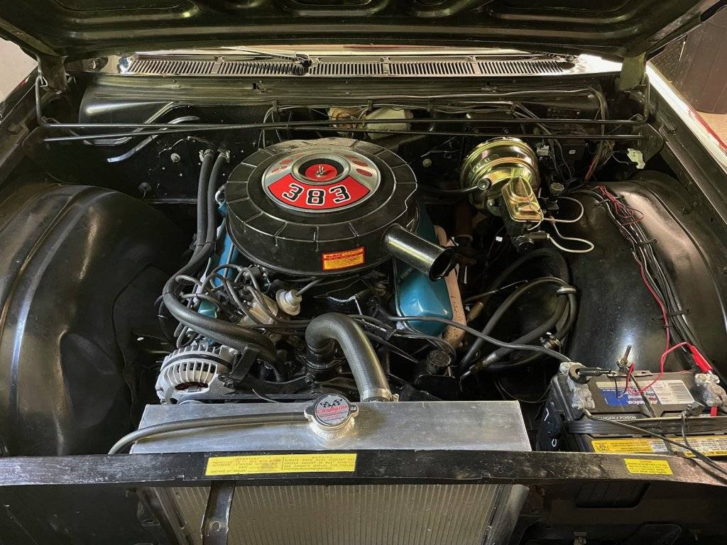

My 1965 Sport Fury Convertible 383/2bbl 4 speed has the original engine, but I just discovered that there is a crack in the lower part of the block. It is not major, and entails some minor coolant leakage. I can live with it for a while and the engine runs beautifully. Everything looks stock under the hood save for the brakes and radiator. Here is a picture:
I will investigate whether repair is possible, but this has me thinking about installing a bigger-inch engine. My questions is - Is installation of a period 413/426/440 motor and mating to the four speed inherently problematic? Does it involve replacement of a lot of parts like radiators, core supports, mounting plates, suspension, etc? I would keep the original engine and possibly repair it if possible for later installation.
Just musing at this point but appreciate all information and viewpoints.

That's too bad about the crack in the block. I wonder how it happened? My friend fixed a cracked cylinder head with JB weld several years ago and it's still holding up. It was on the outside where it was just leaking coolant, nothing to do with compression. I don't really know the answer to your question, but just musing, I think the 383 is a great engine and is probably more plentiful and easily sourced than the other three variants you mentioned. By adding a 4-bbl and good cam I think you could get a significant amount of power out of a 383. I'm just guessing here, but I believe the 383 has slightly less weight than the 413/426/440 because it is not the raised block.
Have you actually seen the crack? Kind of strange to discover a crack in a block after the warm seasons of the year, it seems. Not that it can't happen, just not very normal, to me. Which makes me wonder if it might be a core plug or similar that has started to seep a bit due to internal issues?
Nice looking engine. I like 383s too. In one respect, should be no issues with maintaining the period look of things with the other engine sizes. If you're going to rebuild the motor, why not a stroker for the 383? Incognito and everything bolts right it as it used to.

I’ve seen a picture of the crack. I scheduled it for a once over by my mechanic before the winter and he found and photographed the crack. It’s near the bottom of the block. I may be better off trying to get it fixed if possible.
In my mind a Big Block goes where a Big Block was. The 426 Street Wedge was an option for your car. In '66 the 440 was an option. I am thinking things like hoses and exhaust are the things that stand out. Parts manuals are your friend when you want to do something like this. 50 years ago my father wrecked the family wagon, a '68 Custom Suburban. Somewhere along the line I was going to install a 440. It never happened but I sat down with the parts and service manuals and I bought a New Yorker stub frame. The New Yorker had heavier and longer torsion bars and I had the shop put in the optional HD bars. The 318 and TF bolted right back in.

Is the crack between the freezeplugs? I have a 383 under my workbench with such a crack. It is the only one I have experienced like that, but I have read on teh internet of other folks having similar cracks.
Not common, but not unheard of.
Back in the day, when I considered repairing it, a buddy pointed me toward this company. (I'm surprised I still remember the name).
Precision Metal Stitching Repair - Turlock, CA - LOCK-N-STITCH Inc.
I just browsed a little and they sell kits for DIY repairs.

Personally, I wouldn't bother rebuilding the original 383. You said it runs beautifully, and the crack is the only impetus to this project.
See if the lockstitching kit I posted earlier will work. If so, fix the block, run it a bit to make sure it's good, and store it properly while you use the 440.

Lock and stitch is a permanent repair.
I like the idea of the lock and stitch. When I get the 383 out of the car I’ll have a good machine shop look at it. The 440 is scheduled to be finished and shipped late next month. The feedback here is wonderful. Happy Mew Year everyone. Ben
