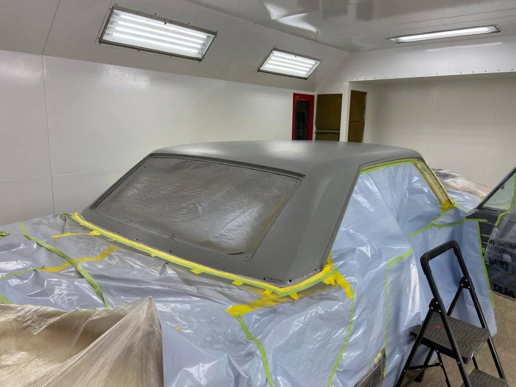

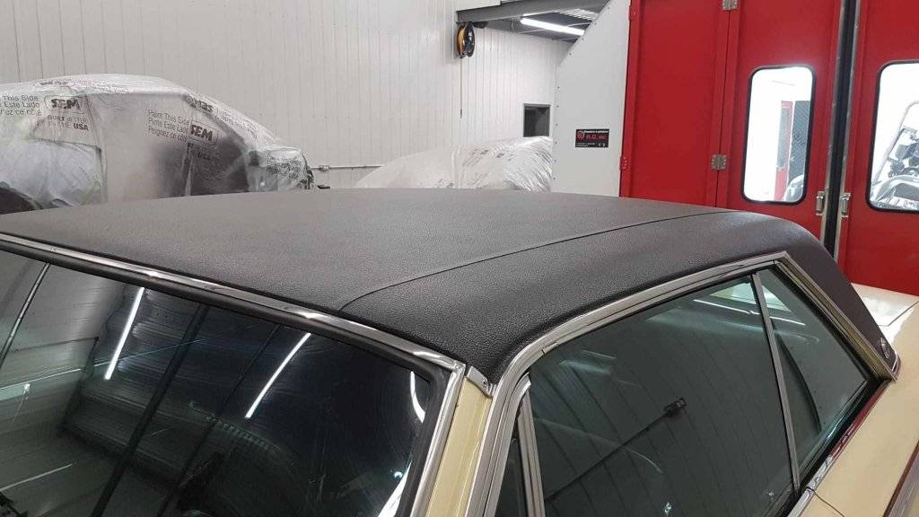

here are some pictures of the roof and vinyl restoration. Obviously, we removed the old vinyl to be honest. The roof wasn’t that bad. We had to do some whole repairs and welding and sanding to bring it back to clean metal then we did a full paint job with epoxy than primer than original paint and yes, we then put a vinyl on top of that might as well put the right colour under it if you’re gonna put a colour
You fixed it better than the factory did in the plant. FULL paint under the vinyl roof covering.
Where did you get the vinyl top material from?

SMS auto fabrication 695 us$ plus shipping cut and stitch to my exact model you can ask them for free sample
Beautiful, and correct looking restoration, and I'd agree that you probably did it better than at the factory.
