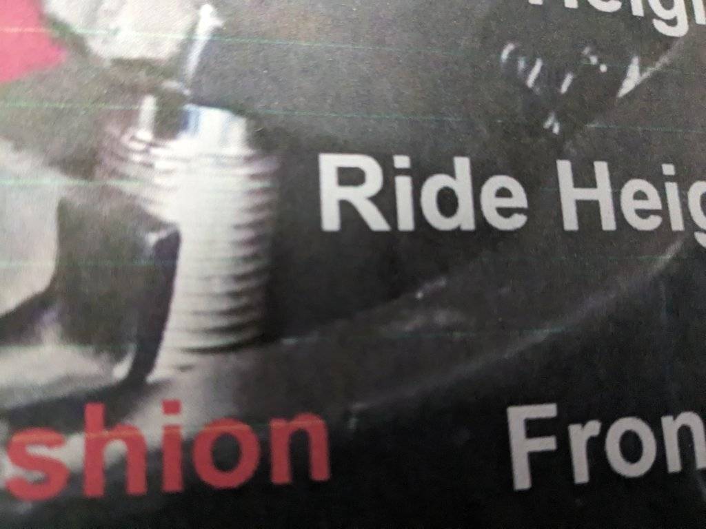

What would happen if I backed out the torsion bar ride height adjuster bolt all the way to get the front end as low as possible ????
Then it would be sitting on the rebound bumper. It would have no spring action so it would ride rough as hell. Fine if it will sit still, not good for driving at all.
Dangerous to drive for you and anyone in your path.
What is your goal with this question?

I would like to lower the front end as much as possible without harming anything or anyone
If it's the original suspension it's probably already sagging some. Reducing the ride height more would really limit suspension travel and you'd keep hitting the rubber bumpers which would make the ride very uncomfortable. I'm not positive, but you might have alignment problems as well.
One thing would be that you realize how undulating "smooth looking" roads really might be.
With the full weight of about 60% of the car's weight (in that nose-down orientation) being tolerated by the two lower control arm bumpers ONLY, the rubber would soon fail and then it would be the metal platform to which each bumper is bonded touching the stub frame itself. Metal ON Metal. Think you've got road noise now??? No matter how insignificant the elevation change might look, it would sound like the biggest pothole you just drove over. IF YOU think it sounds bad, how do you think the car feels after doing that?
Even at factory ride height, there is about 2.5-3.0 finger-widths between the top of the LCA bumper and its contact point on the stub frame, on my '67 Newport factory a/c car. FWIW.

The ride height setting of the torsion bars has nothing to do with how cool it looks but everything to do with car being safe to drive. The factory ride height is the first step to be done in a wheel alighnment. If incorrect none of the other adjustments work properly. As mentioned above ride quality goes out the window. Going around corners is compromised as well as quick emergency moves causing loss of control. Panic braking will have the rear wheels losing contact with the road as the front bumber tries to stop you as all the weight shifts forward onto the front tires. Ability to steer in a straight line going down the highway gone. You will get very tired arms trying to stay in your lane and will probably find the next cop you see asking for a sobriety test.
The torsion bar suspension in our cars works very, very well but you have to respect what the engineers at Chrysler provided us with. Unlike the cars with coil front ends which need to replace the springs as they go soft, we have those little adjusters to crank up to restore the ride and handling back to what it was meant to be.
