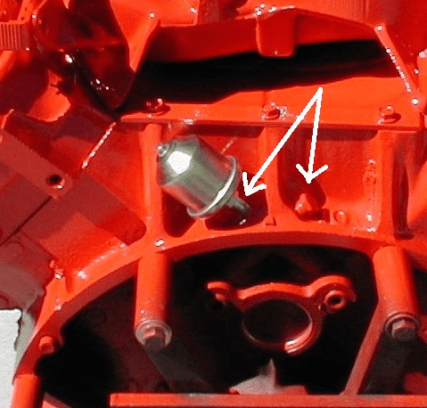

The sender should be 1/8" NPT and if you look on the opposite side of the engine block, there's a pipe plug that you can remove and leave the existing sender in place. That pipe plug is 1/4" NPT.
Thanks for the info! Perfect! I don't remember from the top of my head exactly what NPT thread is on my gauge, but I'm guessing it will fit one or the other.
Sure enough, the oil pressure is reading 20psi at idle with an external gauge. I've ordered a new sending unit hoping that will fix the problem.
