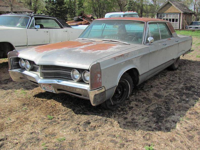

Here's an example of a '67 and a '73 4dr hardtop...

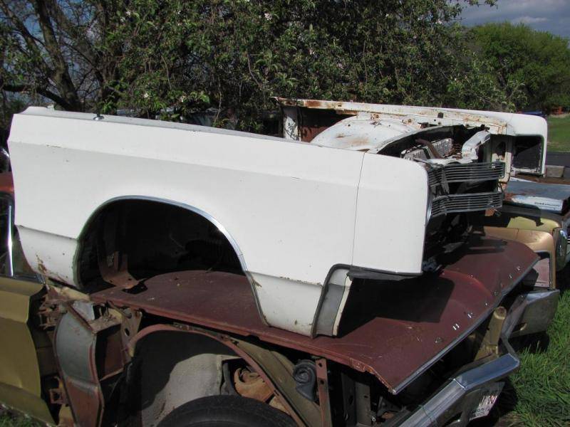

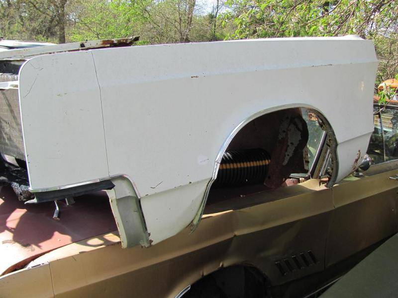

I am parting out a '67 Newport 4dr sdn this week, the fenders and deck lid are spoken for, but I have (2) '67 300 front clips. One is complete, very nice and has cornering lights
Here is the other...
