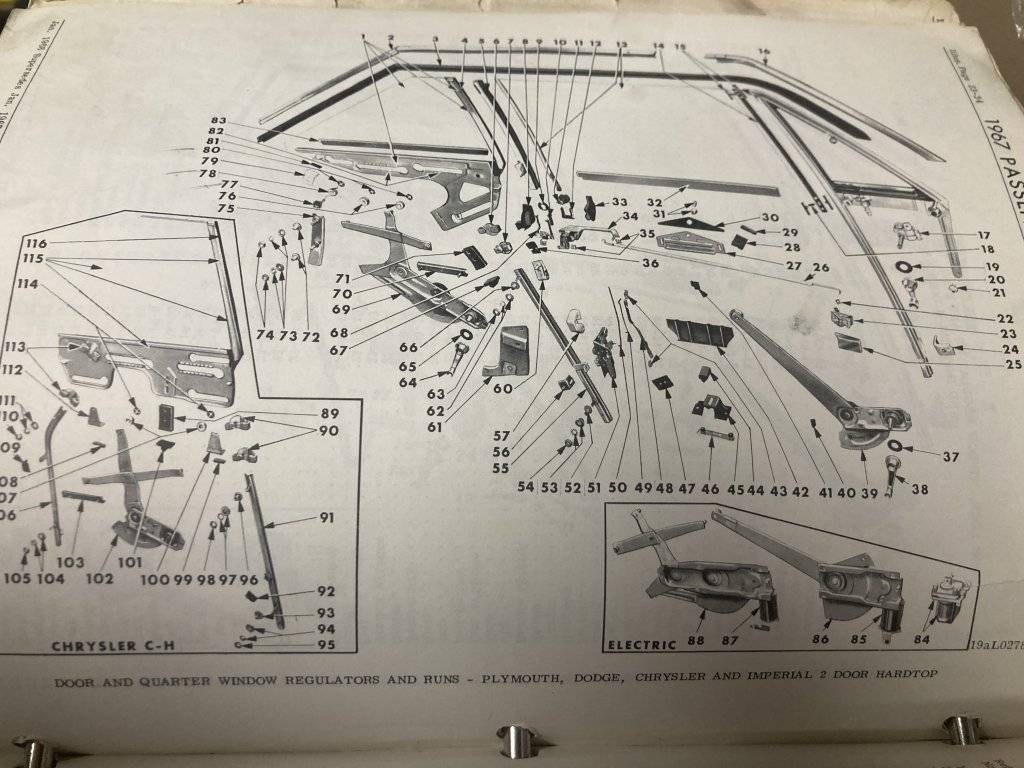

I have a 1967 Chrysler Newport 2 door hardtop that has a broken rear plastic slide on the rear driver side window. I looked in the FSM and that diagrams of that are are horrible at best and unfortunately I didn't get a picture. If anyone has a better breakdown I would really appreciate it. Otherwise I am trying to find that slide, I don't know what the part number is, what it crosses to or if the left and right are the same. I would be thankful for any information, or better yet the part if anyone has anything to offer

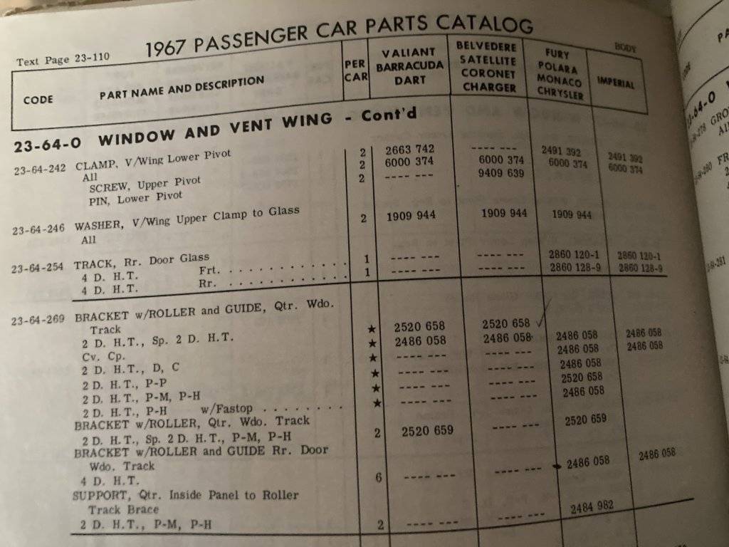

From the parts book.
that is a greet help! thanks Detmatt!! I am needing part 113 in the Chrysler c-h section, do you happen to have a corresponding part number or does anyone know where to locate one of those? I don't suppose these are available through the aftermarket, are they?
Thanks again
That is part number 2486058
