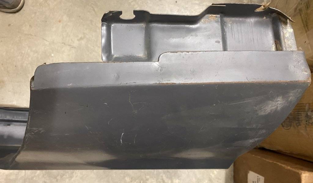

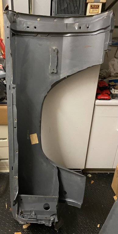

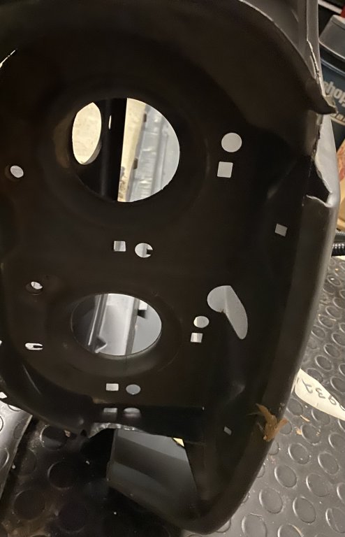

I’m going by memory in my reply. My recall is that there is a screw that attaches the panel behind the bumper to the fender that is hidden by the bumper so the bumper brackets will need to have the bolts removed so that you can take the bumper assembly off or moved forward. There’s a bolt in the upper door jam and another under the end of the cowl. You may need to remove the outer wheelhouse panel. Some reference photos are attached. A Chrysler service manual would be helpful for reference.

View attachment 699566View attachment 699567View attachment 699568
Thanks for the response. I have the Factory Service Manual (FSM) and it has instructions. I’ll combine your recollections and the FSM data and report back in the Elwood build thread.
