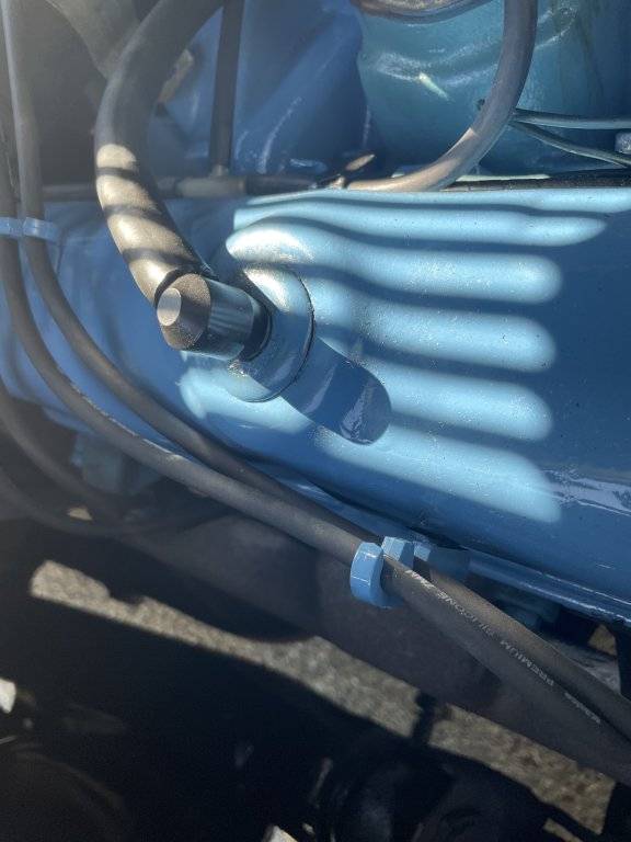

The grommet looks right but the pvc valve doesn’t match mine ? I bought one from autozone doesn’t fit, any one know what I’ve got ?it’s a real short valve , see picture

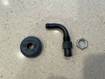

As I said, the metal one I posted in the correct one for 69 and was changed in 1970 to the white plastic ones.

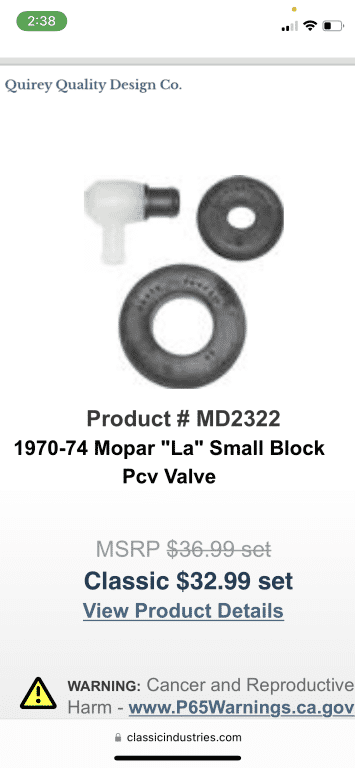

This is what I have now , I thought it was OE maybe not, from classic ind , I don’t want to spend 100.00 do you think this will fit?
First, there was the OEM metal valve. The orig one on our '66 Newport had "Stanadyne" stamped on one of the flats on the hex. At the time, I did not know what "Stanadyne" was, but later found out they built diesel injection pumps (i.e., 5.7L, 6.2L, 6.5L GM diesel V-8 engines). It had the metal "cap" it secrewed into, but could be used sans cap, too, with a rubber grommet.
Second was the OEM hybrid plastic one, which Rolick's website has. Only problem with that was that the plastic could tend to separate from the metal valve. Not good! Posslble source of "unfound" vacuum leaks?
Third was the OEM full-plastic one which came later, by 1972. No problem with it separating when you pulled it out of the grommet. That is the style which almost ALL of the vendors have superceded the metal valve and hybrid plastic valves into.
As our '66 Newport 383 had the netak valve and cap set-up, I just kept clenaing the orig valve as the plastic ones would not work. When the first metal ones came into repro, I was shocked at the elevated price, but the price has elevated more since them.
