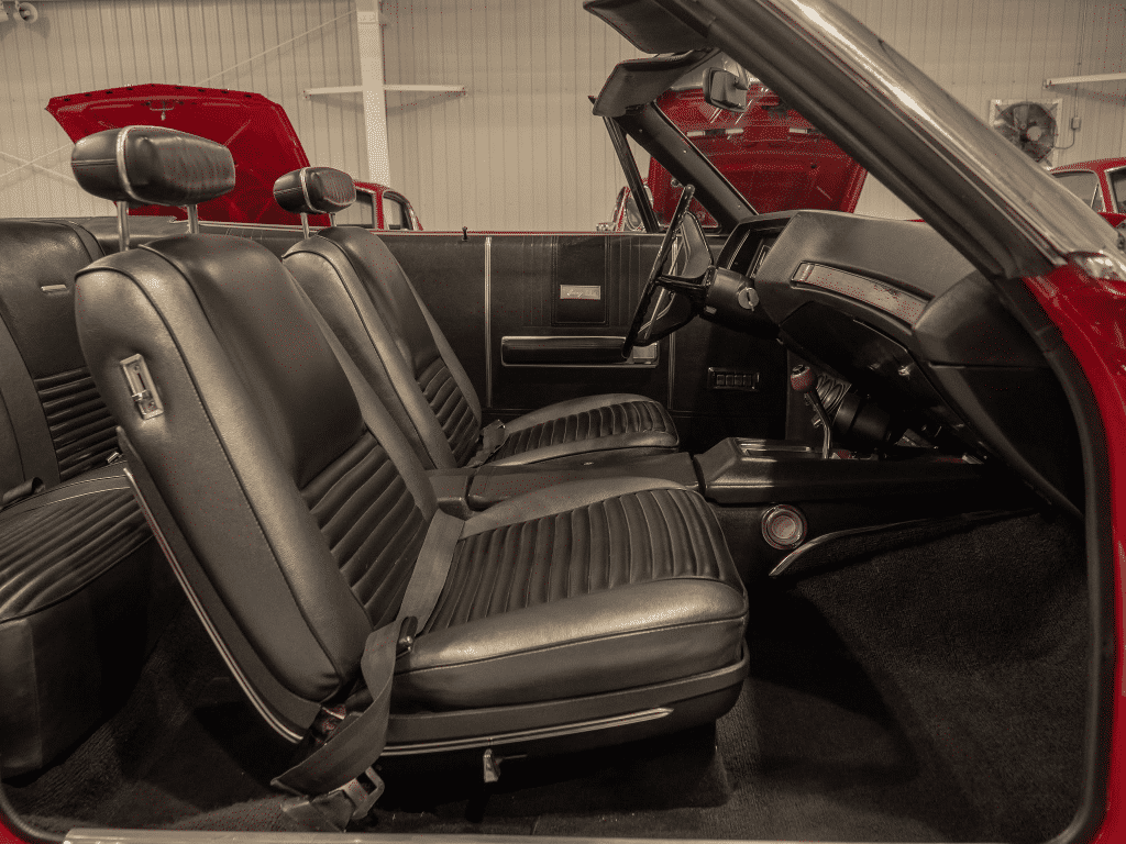

I know you car is a 70SF but my all original 69SF came with the brushed silver top with wood grain shifter ball and was curious if wood grain top would be an option in 69? Why didn’t my car come with the chrome shifter knob?Where these actual options or what the guy on the line decided to use?
So am I to understand that the console is just like many other things mother Mopar did. There is the “correct one” that most cars got but then there are oddballs that were installed by accident or because that is what the factory had left when the car came down the line.

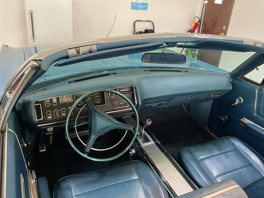

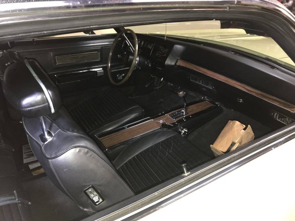

Personally, I like the woodgrain top of the "traditional" console more than the (harder to keep clean) brushed aluminum, but that is me. As woodgrain was also more upscale in those times, too, related to dash and door trim. Yet the padded console might better fit the "padded" orientation of the Fuselage interiors.
On the "traditional" console, there are a few threads in here about the console SHIFTER being longer on the C-body-only applications. Maybe an inch longer/taller? Yet I suspect they all have the same mounting flange where they attach to the floor pan.
