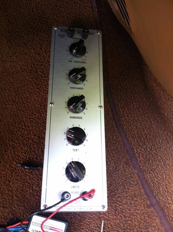

Hi Big John
I finally got my vintage Decade Box yesterday after ordering it on ebay

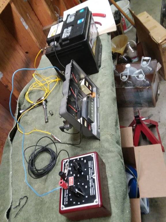

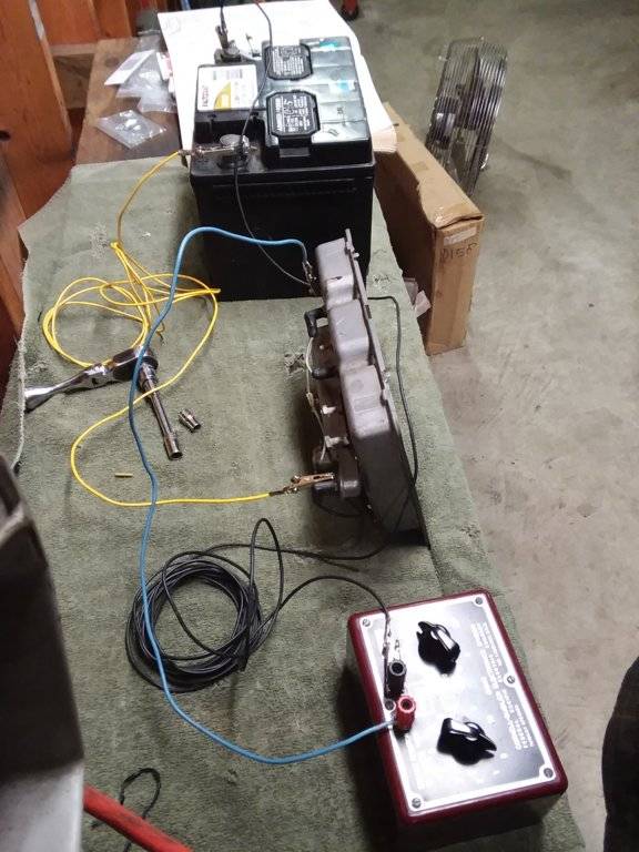

Gage Test
· Old mustang battery, 6.11 volts. Pos to LS Inner spade of Inst Panel Voltage Limiter. Negative to black term of Decade Resistor box
· IP Voltage Limiter (IPVL): RS single spade is output to temp and gas gages. LS inner is ign input power. LS outer is connector to radio capacitor. Believe supposed to reduce input to 5 volts.

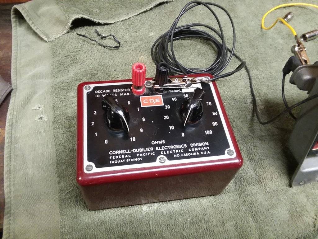

· Decade Resistor Box: tested with Fluke 78 ohmmeter @ 10, 23, & 74 ohms. Accurate to less than 1 ohm. Move Positive to ground terms of gas and temp gages as test each. Big John on FCBO: 10 ohms should correspond to full on gage, 23 ohms middle, 74 ohms low on gage
· Gas SF, 10 ohms > ¾ tank, 23 > 3/8, 74 > no reading, 50 ohms to move needle
· Temp SF, 10 ohms > 5/8 across gage dial, 23 > ¼, 74 ohms, needle barely moves from lowest point
· Conv Gas: 10 ohms > ¾ tank, 23 > over 3/8, 50 > 1/16, 74 > no movement
· Conv Temp: 10 ohms > less than half, 23 > ¼, 50 > slight movement, 74 > no movement

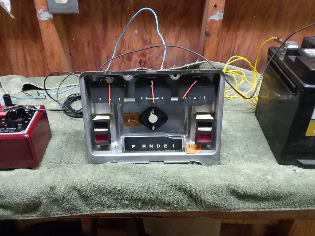

I'm going to use the temp gage from the Sport Fury and the Gas from the Convertible.
Works better with RS on 10 and LS on 0
Still need to hook up the yellow to IPVL input spade to get the gage to read
Forgot to take pic on gas gage reading, use temp
