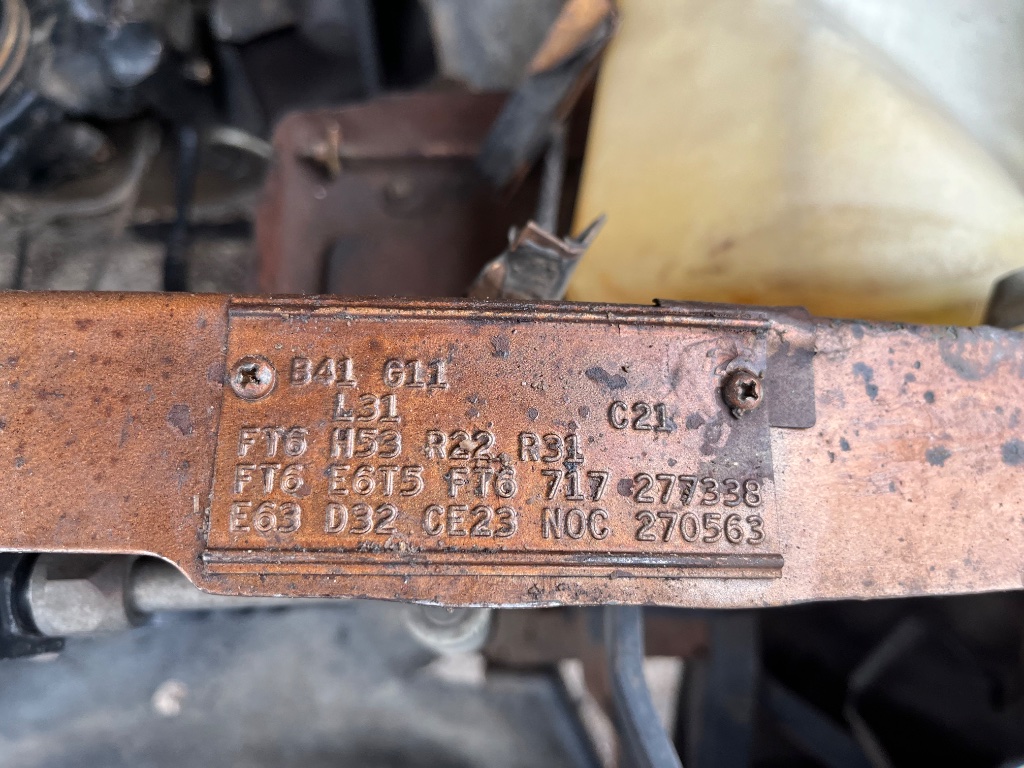

Can someone help me to decipher the trim plate codes on my 70 barge…
Google, "1970 Chrysler Newport build tag decoding". I just did that on my '76 Cordoba, there are several sites but look for the one you fill in the blanks using information from your build tag.
CodeDescription
E63383-4 Barrel
D32H-D A-727 TorqueFlite Trans / Some Years A-998
CE23
C = Chrysler
E = Economy
23 = 2 Door Hardtop​
N0CN = 383 330HP OR 335HP 1-4BBL 8 CYL
0 = 1970
C = Jefferson Avenue, MI, USA
270563Sequence Number '270563'
FT6Paint Code: Dark Tan Metallic / Burnt Tan Irid
E6T5Trim Grade/Style/Color
E = Economy
6 = Vinyl Bucket Seats
T5 = Saddle Tan
FT6Upper Door Frame: Dark Tan Metallic / Burnt Tan Irid
717Date Built: 7 / 17 / 1970
277338Order Number: 277338
FT6Roof Type OR Color: Dark Tan Metallic / Burnt Tan Irid
H53Single Air / Temperature / AC
R22AM w/ 8-Track
R31Duel Rear Speaker w/ R85
L31Hood / Fender Mount Turn Signal
C21Center Seat Foldown Armrest
B41Front Disc Brakes Some Yrs. Power
G11Tinted Glass All
CodeDescription
E63383-4 Barrel
CE23
C = Chrysler
E = Economy
0 = 1970
E = Economy
T5 = Saddle Tan
R22AM w/ 8-Track
G11Tinted Glass All
Thanks so much - you were able to fill in ALL the blanks that I had left after visiting:
Mopar Option Codes - Mopar Fender Tag Codes
Thanks again VERY much!

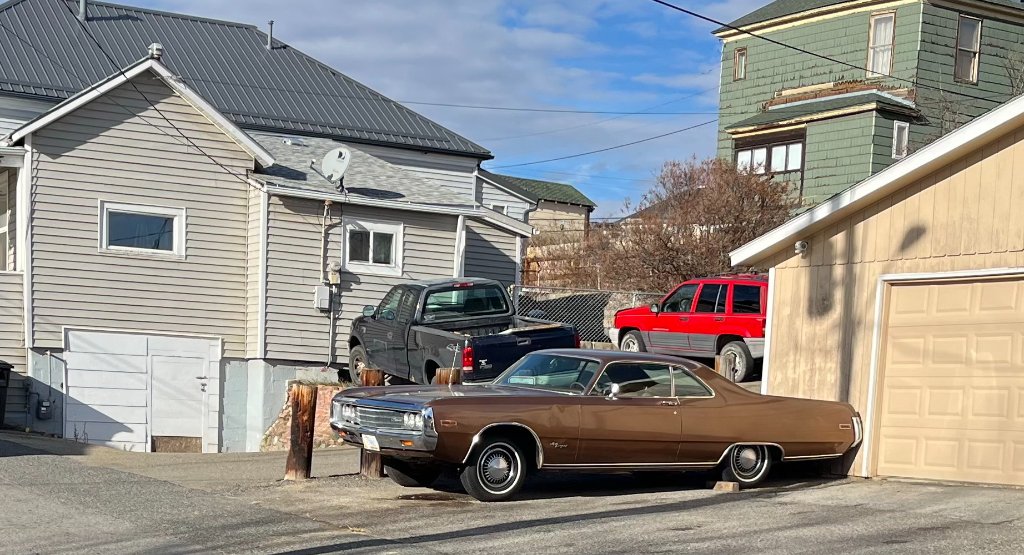

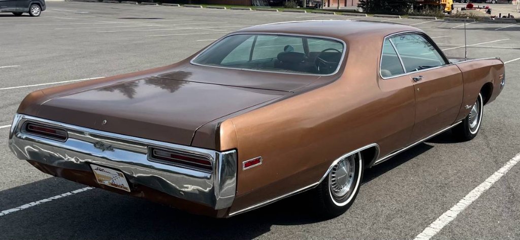

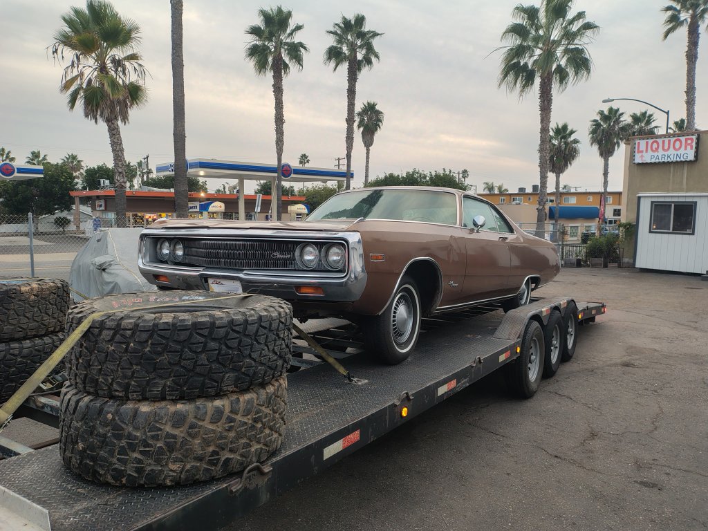

That’s got to be one of the last 1970 models off the line. Can you post any pics of the whole car?
