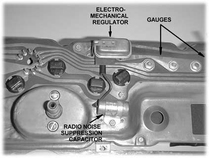

Thanks for this great info. Immediately after reading this I drew a red flag. I do not believe I have a 5 Volt dash voltage limiter. Would it look like a capacitor connected by a wire? If so where does it connect to? The positive terminal on the gas gauge?
I would think your car does have such a voltage limiter since the gas gauge needs a constant reference voltage so as not to fluctuate with actual alternator output voltage (the latter changes for a moment if you step on the brakes or turn on the headlights).
The voltage limiter is a small squarish metal box plugged into the back of your gauge cluster, the location of which should be somewhat similiar as seen on this picture:
The round thing you see there is a capacitor to suppress ignition noise for a better radio sound, not a resistor.
There are eletronic versions of the voltage limiter available nowadays and should be preferred if the need for replacement arises. This Allpar article is recommended reading on the voltage limiters.
If there is no small squarish metal box plugged into the back of your gauge cluster then the voltage limiter is in the gas gauge.
If the gas gauge has three terminals then it is in the gas gauge.

Looking under my dash last night, I couldn't see any silver box plugged into the printed board. I did notice a spot where it could be plugged in, though, and thought, what the hell...where is it? Maybe it's way up in there where I can't see. I was hoping I could change it without removing the cluster. The FSM states that one can by lowering the steering column.
Does anybody have any photos of the back of their cluster?
