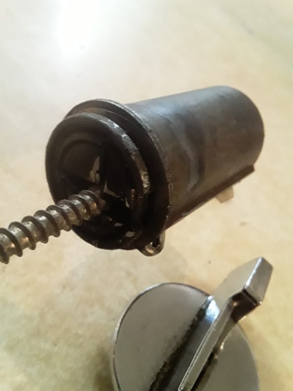

FOR TAB RETAINED CYLINDERS. NOT FOR THE LATER SCREW RETAINED CYLINDERS.
The rotating lock "tumbler case" is difficult to drill, very hard stuff. The chances are high that the drill bit will break before the drilling is done. The cylinder "bezel" and "outer" stationary cylinder are soft.

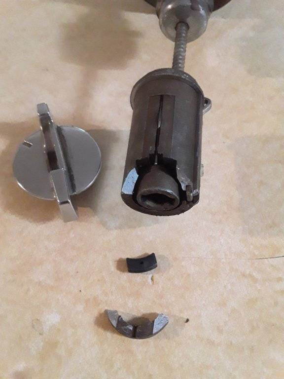

The slide hammer easily removes the soft bezel with no drilling so the cylinder can be attacked. The little Dremel with the course "cutting" wheel (not grinding wheel) easily cuts a cross into the hard lock "tumbler" case face that the key slides into so the slide hammer can remove the tumbler and cylinder assembly.
The soft "outer" cylinder breaks with very little effort. It didn't take a big hit to get it out. The whole rigmarole was about ten minutes. The new one with key slides in, no tools needed.
This cylinder is retained by the little dark curved tab in the picture.
So, hit it with the slide hammer, or just take the wheel off and take the steering column apart.
The later ones that are retained with a screw "will" break the steering column collar if a slide hammer removal is attempted. Know what cylinder you have.
What you are displaying is how a quick car thief would do it. Good pictures.
In the world of Saginaw steering columns, the two key cyl retention methods are used. The screw or the spring-loaded end tab. As Saginaw built the Chrysler columns to Chrysler specs, there were still some similarities between what Chrysler used and what GM Carline divisions used. What I'm going to mention is what I have seen in Chevy/GM service manuals. In some model years and different assy plants, the columns used could all "look the same", but have either key cyl retention orientation.
One service manual had illustrations of how to identify the retention method. Should the "screw" not be visible, the manual indicated a "square" part of the casting which had to be knocked-out to get to and depress the locking tab. That part of the casting was thinner than surrounding areas to facilitate such "knock-out" actions. When the "window" was cleared, the locking tab is visible and can be depressed to allow the key cyl to be easily removed.
This is where reading the Chrysler or GM or Ford or otherwise Factory Service Manual can come in handy and be informative!
In destroying the key cyl to use the slide hammer, DO ensure you have a new keyed cylinder at hand to put in the place of the destroyed one. Then getting the door cylinders re-coded to match the new ignition key.
