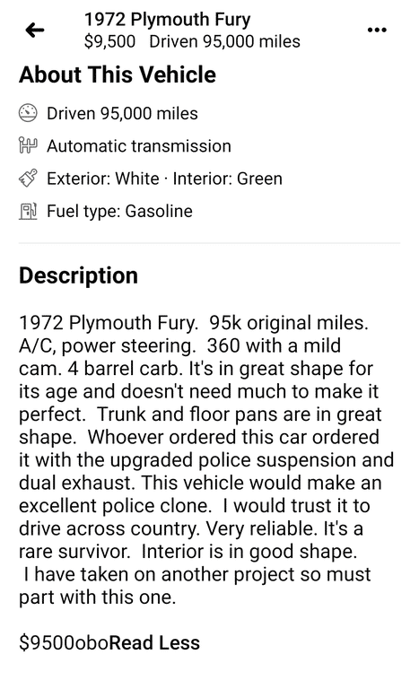

The ad mentions dual exhaust and police suspension. In the seller's text answer that becomes "civilian car with a police package special order". A dual exhaust on a 360, did they have that option in 1972?
Like @68PK21 440.6bbl says, the broadcast sheet will decide. Codes N41 and S16 should be included.
The 360 didn't get a four-barrel until 1974 (to replace the 340). The "K" engine designation also denotes a two-barrel 360; however, they did offer the 360 as part of a police package at this time. I doubt any two-barrels had factory dual exhaust.

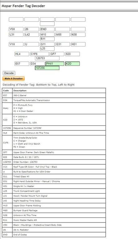

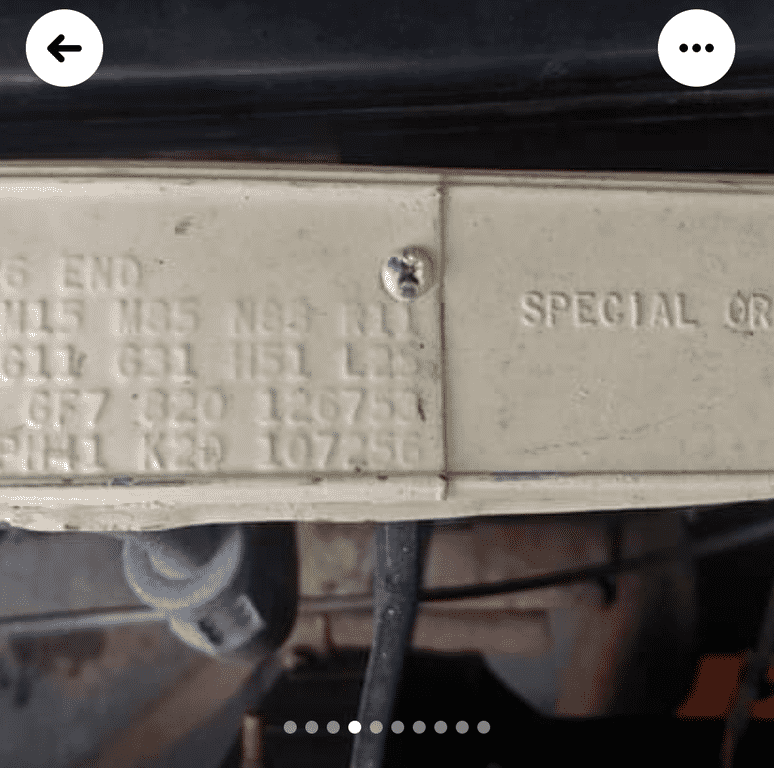

I banged out the fender tag on a decoder and only discrepancy I can see is the N38 code which came up as "Unknown At This Time". Change that to A38 and we have the 'Police Package'. A mis-stamped tag? Could be as the N38 follows the M85 Bumper Guard Package. ???? only the build sheet will tell.
Full Tag for reference in this post:
N38 Tag Decode:
03-28-21.Mopar Fender Tag Decoder.1972.FURY.COP.CLONE.N38.www.stockmopar.com.jpg
Also K in K2D comes up as Unknown. Anyone?
Thanks for the full tag! Change N38 to N88 and you get Auto Speed Control.

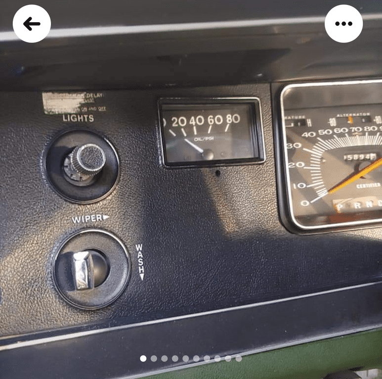

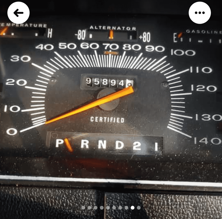

OK your probably right as I enlarged it again and compared the what I thought was a 3 to the other 3 in L31 and now I'm more in the it's a 8 so that what's it could be then. I did come across a E body tag decoder that listed a very long list of the 3 codes and spotted:
F95 Certified Speedometer
F96 Oil Pressure Gauge
and wondered if these would pertain to this C-Body. I have a feeling someone started a clone car and the story evolved (stretched) over the years when it changed hands. It's a shame because if it was kept original as a Fury III with vinyl and some kind of A38 car that would make it more unique IMO.
K2D ?
K=360
2=1972
D=Belvidere
