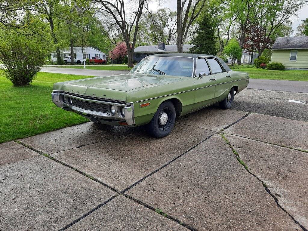

1972 Polara 4 door sedan interior interchange?
66l78rat
Aug 28, 2017
587
738
troy mi
Can anyone tell me what years/ models will interchange with my 72 Polara 4 dr sedan? Not concerned with correct pattern,just fit.Example,will a 1972 Chrysler Newport interior fit my car?
