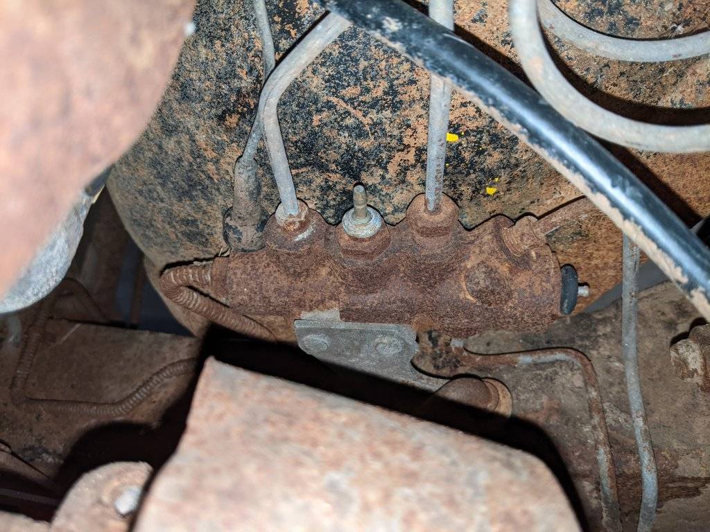

I’ll have to check the grounding with the switch but my brakes work well but where is the valve that the brake warning light hooks up to at? Sorry but this is my first car.
It's generally in the engine compartment directly below the master cylinder
Looks like this. Wire for brake light connects to the pin in the center.
