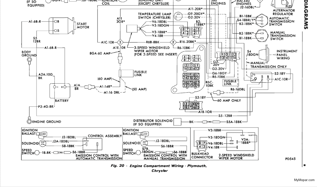

Service Manuals – MyMopar
And they have a '72 Chassis manual. I looked and there isn't a second wire for the NSS. There is an alternate for the manual trans that goes to the clutch pedal, but that's not applicable here.
My bet is someone added a switch or jumper wire to bypass a bad NSS.... Otherwise, I have no idea where another wire would be coming from. It makes no sense to have another source for the ground needed for the NSS.
Yeah it's factory not aftermarket I am 99% sure of that.

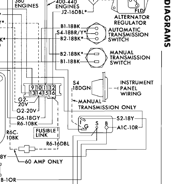

Thanks - that is not the right diagram. I need two wires coming off G in that circuit going to trans (same color) tied in - may be a 72 only thing.The other wire shown for manual trans only which this isn't.
That is from the '72 chassis manual.
A larger shot of the same diagram showing "Chrysler".
