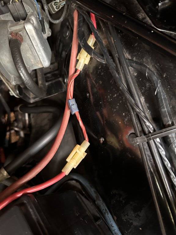

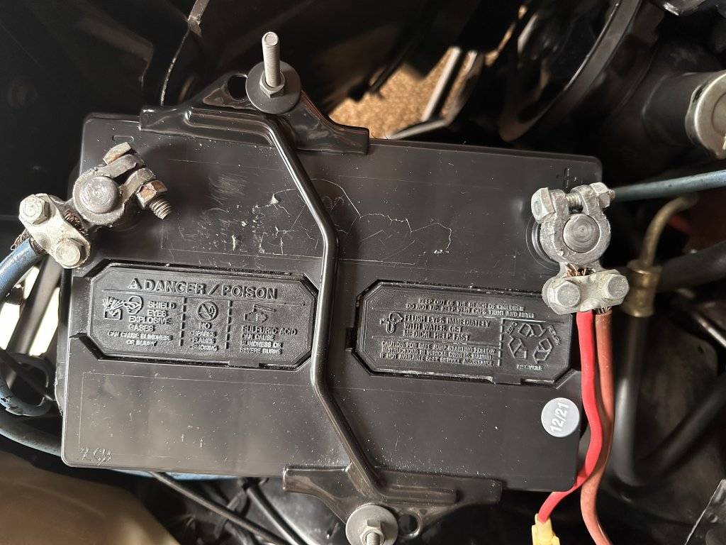

I think I found the difference, 71 imperial uses a black spade connector for the fusable link and the 73 uses a bullet connector. Evan's told me that I will not be able to get that connector, (the bullet style) and would have to splice the spade style on to my positive harness. I will order up the solder on battery terminal for my positive, as that is the only reason for the cable replacement. I can't stand the bolt on terminals.
