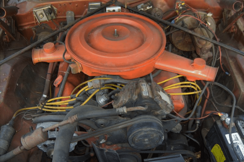

I recently got an air cleaner from a 74 Charger, dual snorkel with one longer than the other. Says "440 Magnum" on the cover
I seem to be having trouble finding an air filter that fits, anyone have any suggestions? Most seem to be too tall to clear the cover, must have to be some kind of slimline ?
Look through this list of air cleaners, find yours and the filter part number is on the right.
Thanks for that link. It should be noticed that Chrysler had basically 2 air filter numbers (at least in Fram) that covered pretty much every round air filter element. Not oval, not oblong, etc., but pure round. The CA127 Fram fit the older filter housings, 2bbl and 4bbl, with the air cleaner base being separate. The CA305 Fram fit the newer (after 1968) housings, 2bbl and 4bbl, with the flatter top of the air cleaner being the one that comes off. Those two filters should still be around, maybe just not in stock locally.
Just some thoughts,
CBODY67
One more thing, can I swap the breather into the passenger valve cover? On this air cleaner, the breather is on the passenger side. I would have to move the pvc into the drivers valve cover
You'll need the later model valve covers to do that.
