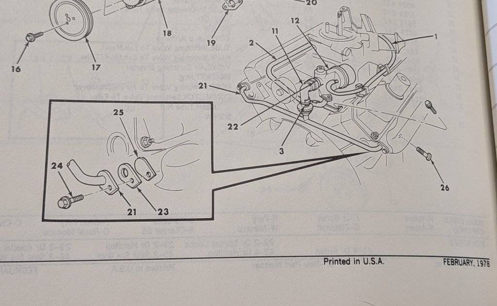

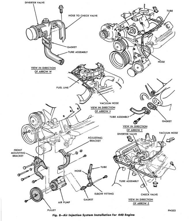

I'm thinking that you mean the air injection pipe and the leak is at arrow Y (lower right corner of pic). This is from a 1978 FSM, but it's probably the same for your 1977.

Thanks, yes that's it. IF i don' t block it off what are the other option(s) to stop the leak ?

The part is the air pump, or aspirator, crossover pipe. It connects to the back of both exhaust manifolds as shown in John's image, or as in the following image, which is for a 1977, and the same as 1978. The pipe fitting/flange is secured to the manifold with a stainless steel bolt with a gasket. It's possible your gasket is blown, and/or the bolt is loose.

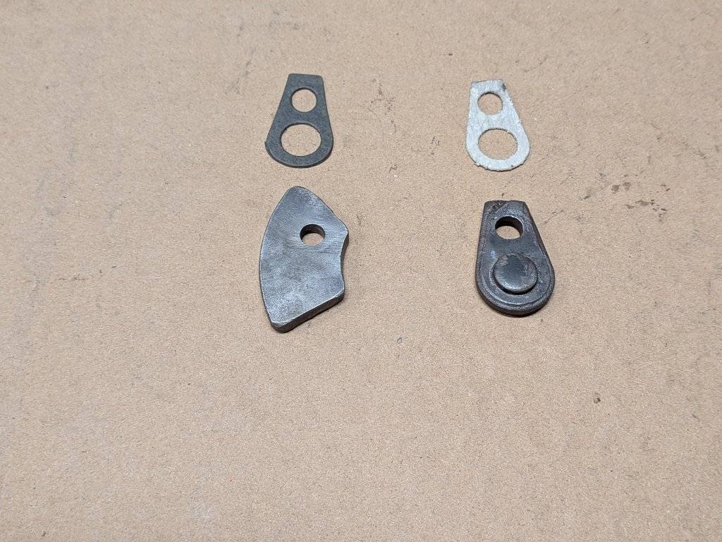

Chrysler produced a block off plate for vehicles not equipped with the air injection system, shown as item 25 in the foregoing image. It mounts with the same bolt and gasket. The part number for the block off plate is 3751249.
The original block off plate is shown, on the right, in the following image, with an original asbestos bearing gasket:
Before I learned of the factory plates in the 80s, I made my own from 3/16" steel plate as shown on the left in the foregoing image with an aftermarket gasket.
