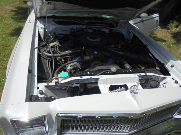

OK, is it me or has the firewall and fenders inside the engine compartment look like they were recently painted? My issues are with the square plastic glides for the hood props, they are painted white. On my 78 Chrysler, they are the tan/beige -natural color of the plastic material.
No it's not you, that caught my eye too. The white kind of 'POPS' as they say in the house renovation world.
When enlarged the picture in another browser tab to 200% the white stands out too much, you can see aged corrosion and the dirtiness of nuts and bolts going into the firewall but no or not even a little dirtiness around the attachment points. The rust and paint pealing on the A/C metal line is odd for such a low mileage car but being in Vermont in a not climate controlled environment the metal can sweat when the temps go from freezing to say 50 degrees which will cause corrosion anywhere on the car inside and out.
Seems to be a missing wiring connector on the orange unit on the firewall in the left side engine shot.
In the larger hood open shot you can see over-spray on the hood latch and safety latch so maybe it was in a accident and those weren't painted from the factory. Some white painted bolt heads that I think were not painted white from the factory can be seen.

(edit) I've seen the bushings painted the body color on this era car back in the day so I don't think it's to much of a concern, but that area is also a spot you can look for a re-paint.
overspray on the inside fender near the brake booster.
