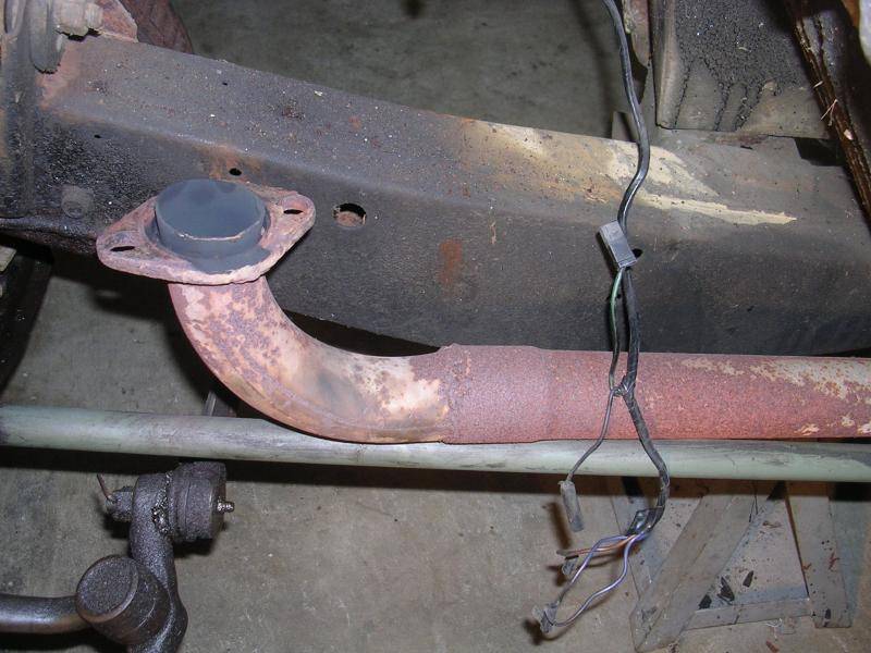

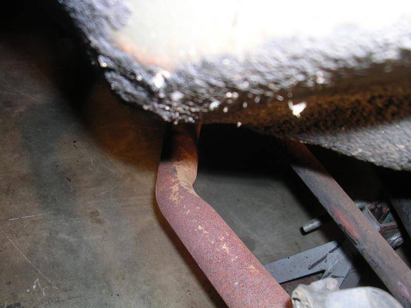

Pictures below are LOL. They are right side and left side bends in my 2 inch 440 exhaust system. No wonder it ran slow, it couldn't exhale.
