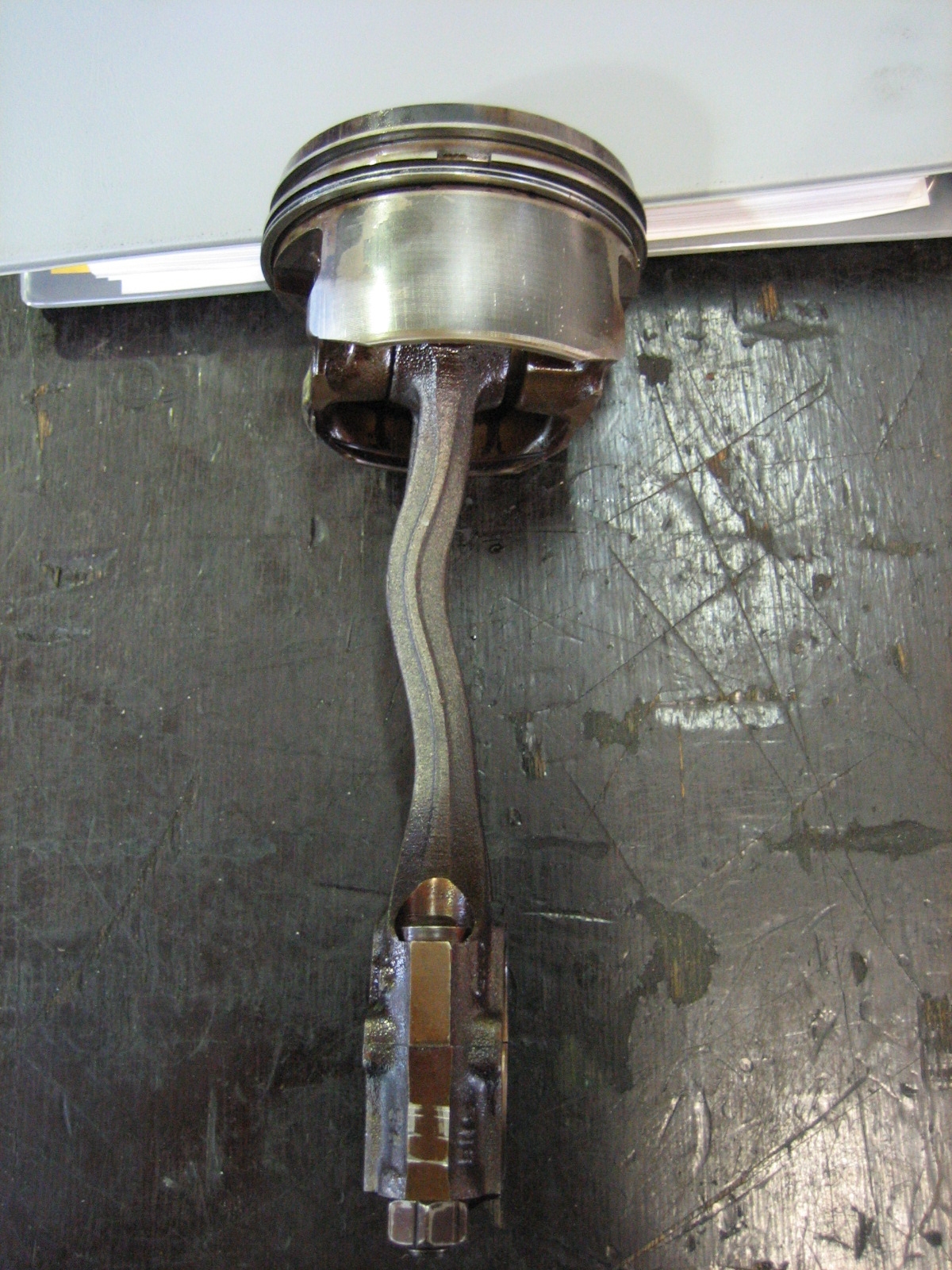

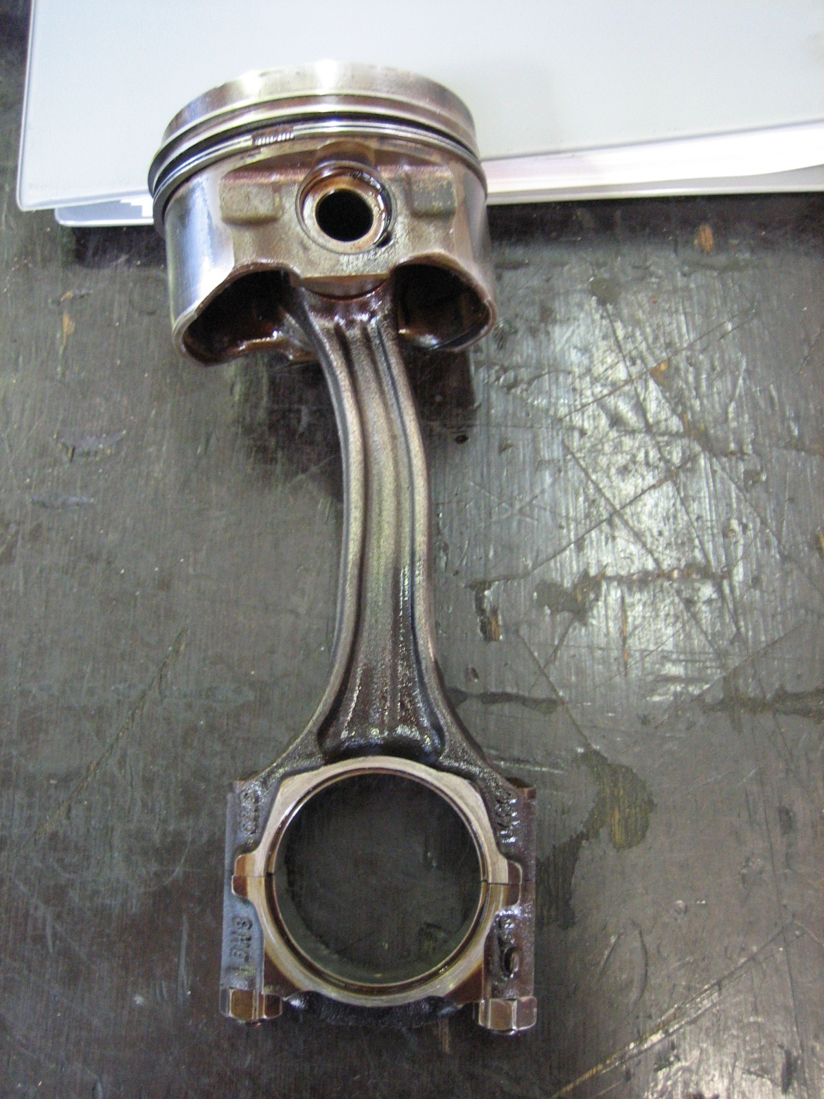

Being an airplane guy, I hope and I'm sure he knows how to take care of a radial engine. The bottom 3 cylinders, that is the ones at 5,6, and 7 o'clock can fill up with oil from the crank case MUST be drained or turned over manually to get the oil out. Most aircraft with these engines have a sump system to help keep the oil from filling up the cylinders. If not they can hydro lock. As cool as radial engine are, they are a huge pain in the *** to own and maintain, and I take my hat off to those that do.
I've read up on that before ... can be pretty catastrophic if you attempt to start it with them full
Hydro-lock bad
