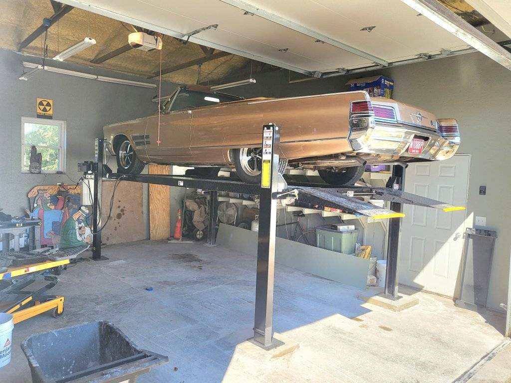

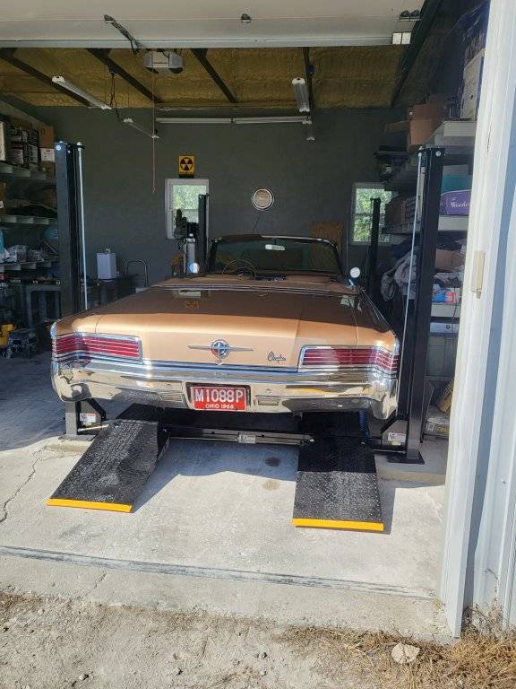

I had some extra work involved in my installation. I have a garage space on my farm which my grandpa poured the concrete probably 75 years ago. Good quality concrete but definitely not level. I cut and jack hammered out 3 areas, I increased the areas from 1/2" to 3".
A skid steer definitely made it much easier. I had a platform jack I used too and was able to assemble it by myself.
I did have one issue because I had it on concrete piers, I can't move it after assembly. I had to cut one of the safety release rods and weld it in place, because the need to feeding it through the front of the lift. I am 3 feet from the wall and the rod is 5 feet long.
I am very happy with the lift so far. I have a 2 post also but will use this when I am not removing the wheels. I will probably eventually buy a sliding jack for the 4 post.

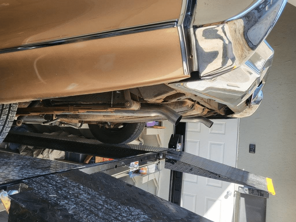

I got a closer inspection of the dual exhaust for the first time.

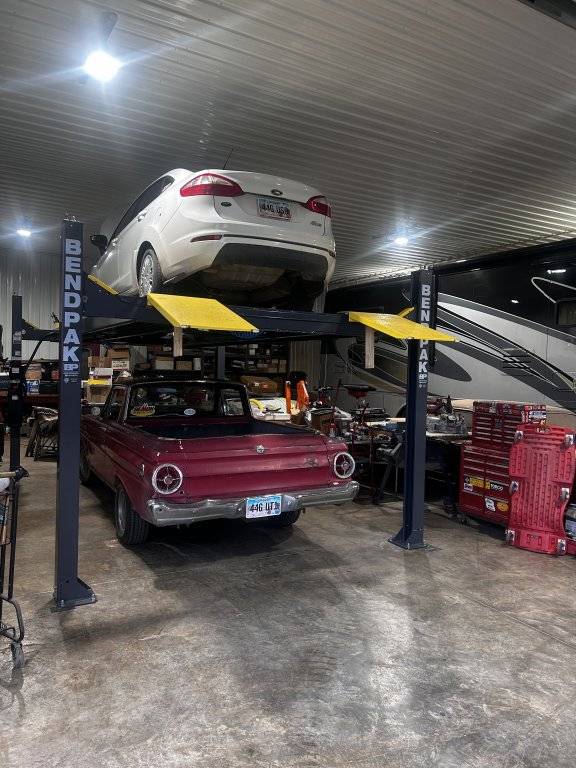

Nice! I’m really enjoying the Bendpak 4 post lift with the air jacks. I rotated the tires on Lucy, our Bronco and it was great to do it without crawling underneath it.

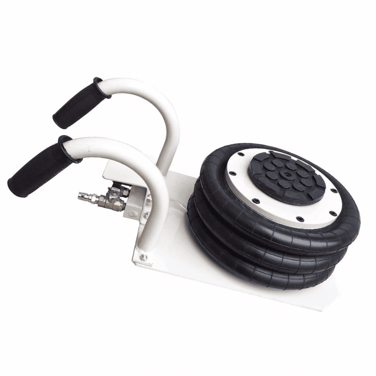

I also invested in a couple of these air jacks. These really need to be used with a jack stand or blocks as I wouldn't trust them too far, but they do make things easy. I used just one for a while and then decided they were cheap enough to buy a second one so I could put one on each side if needed.

I also use the Bendpak air jacks for lifting my vehicles .
BENDPAK RJ7W 7,000-lb. Capacity / Rolling Bridge Jack / Easy-Roll Wheels
I can’t tell which brand you have, but maybe these will work or your manufacturer might offer something similar.

Here is the beauty on the 4 post. My wife got a new car and they didn't want to give her anything for her 15 year old Beetle, so she said you have 5 vehicles I can have 2. I said if you go in half on a purchase of a 4 post lift, I can store you Beetle inside on the farm. :lol:
I have also found out I really don't like how the convertible flexes on the 2 post. I may never service Goldie on the 2 post again.
