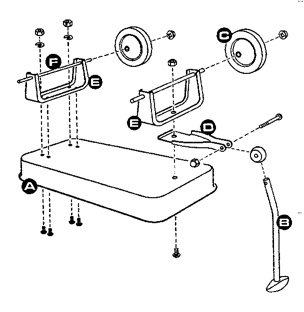

Here is an assembly diagram to help... the 4 speed should be doable, but I think the 440 will crush it.

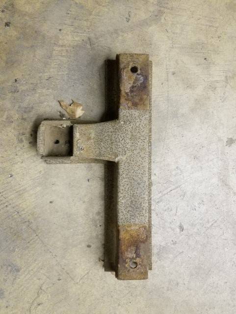

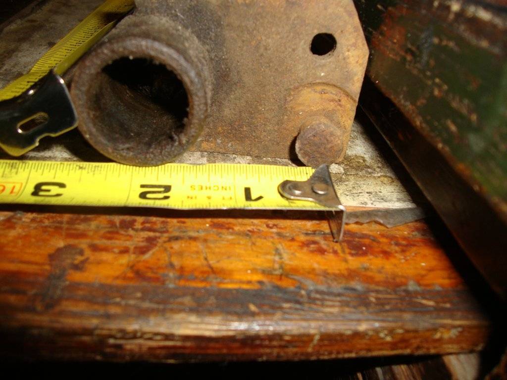

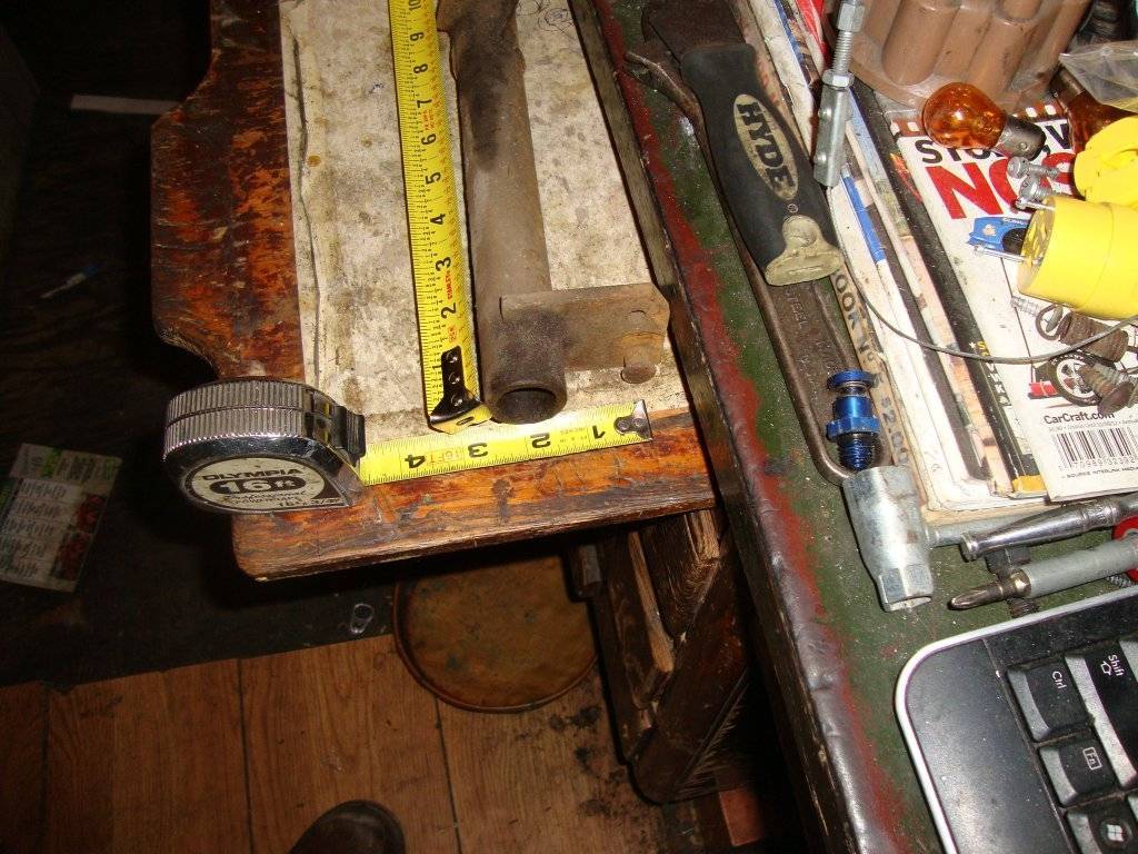

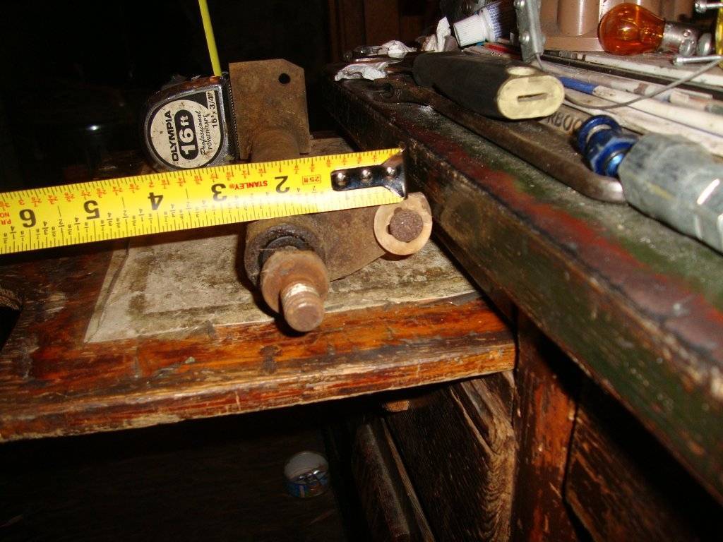

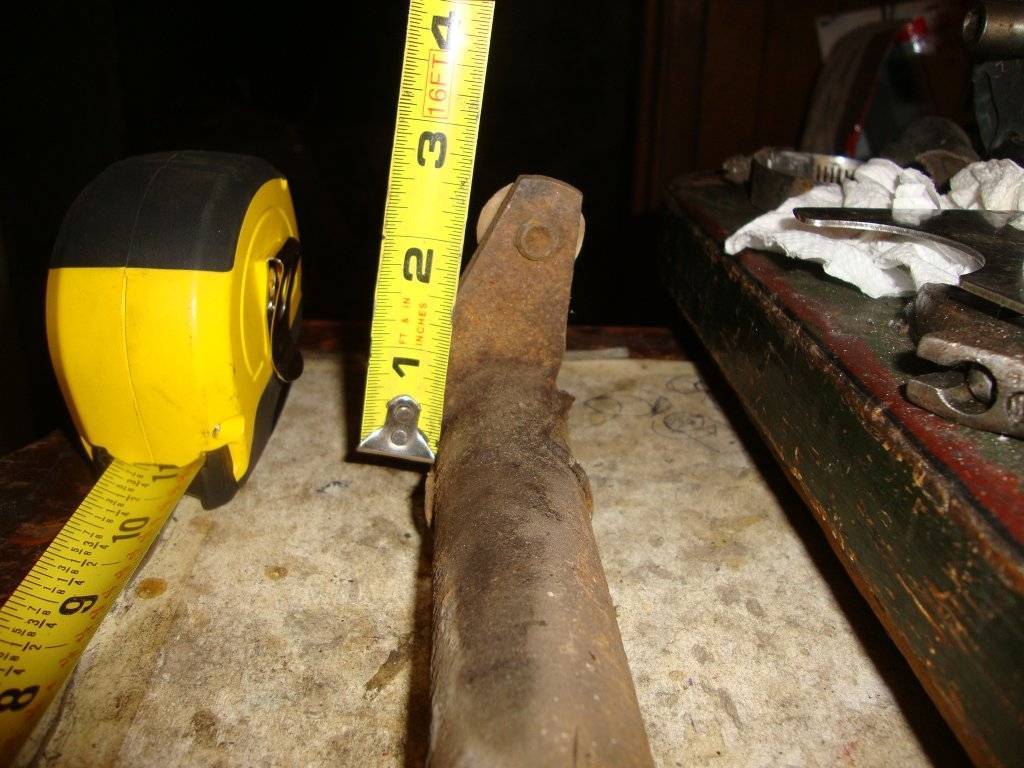

well not sure of your c bodies year . but this came from a 66 c body . just to convert it from column shift to standard a833 4spd trans . oh and yes on 4spd wagons , with hp motors as well . here a pic of my wagon . and one i converted . its a hit when i bring it out . great ate it , lol .

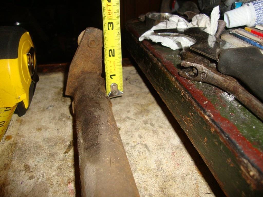

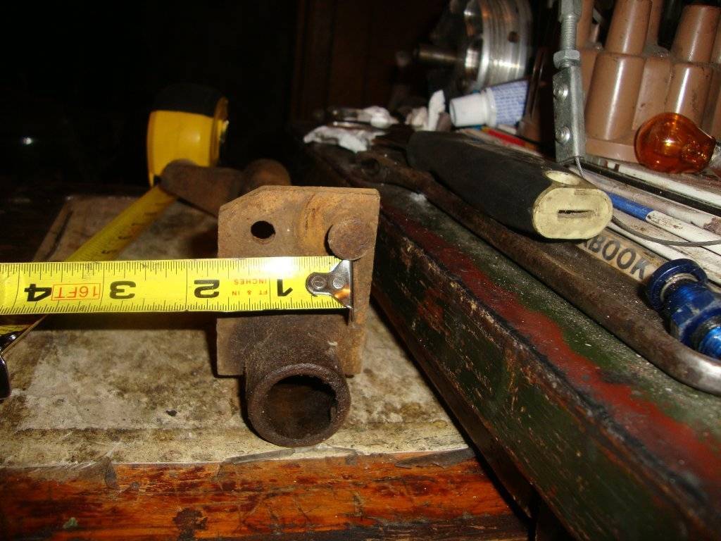

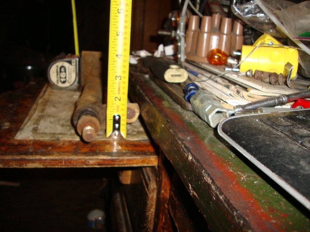

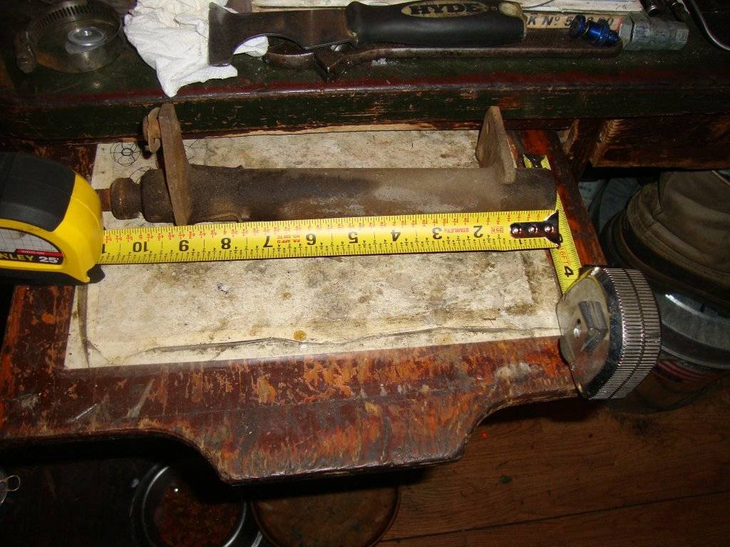

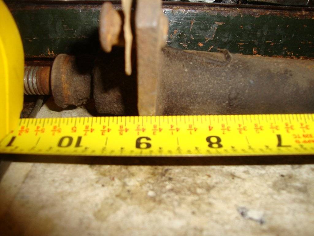

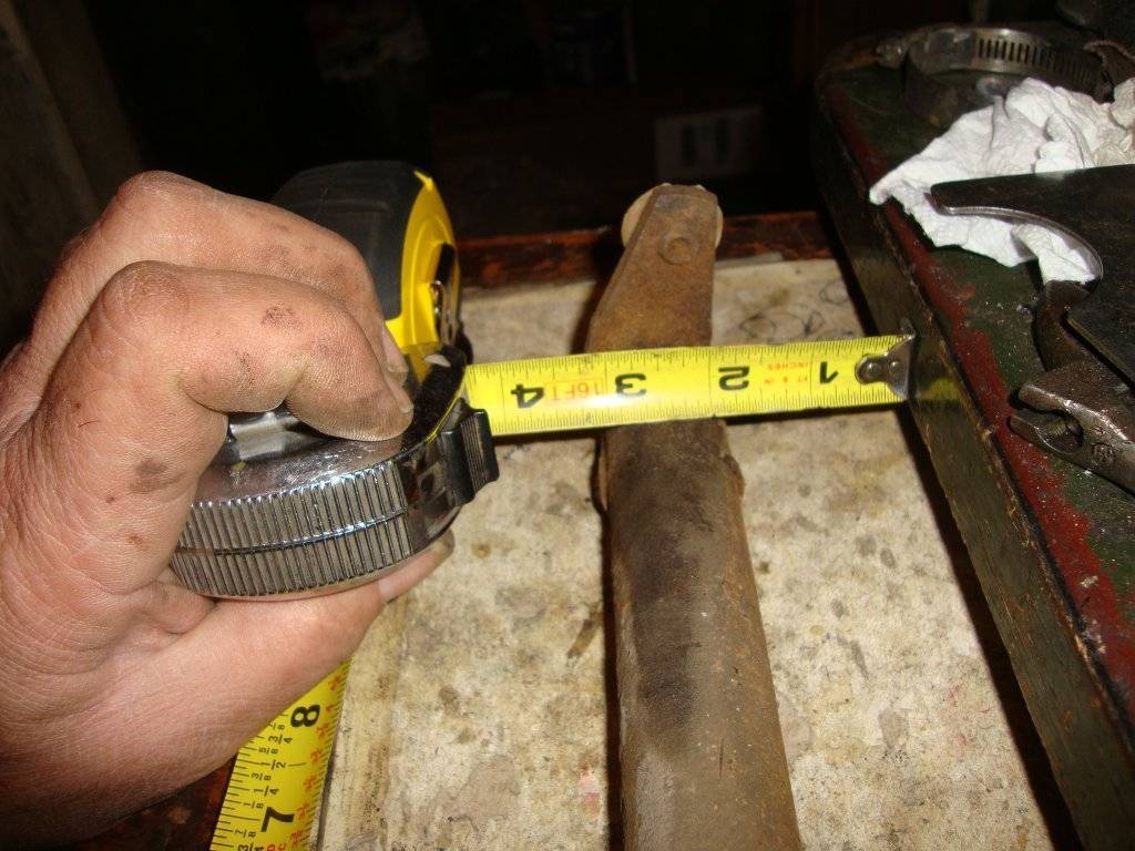

that pic i posted is the parts you need . and juice clutch releases and a833 tranny's is not a cheap setup . the z bar and its frame mount bracket is the tuff parts to come up with . hese some of that z bar . people have used there b and a body ones with heavy mods .

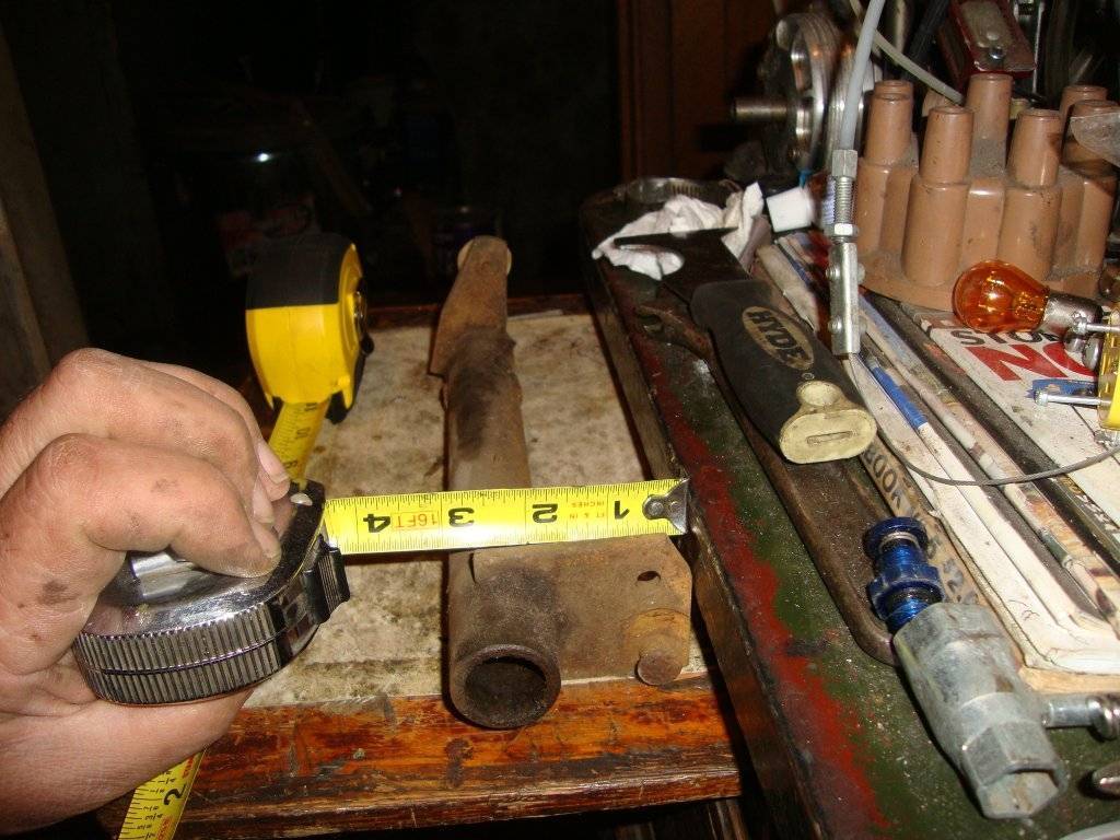

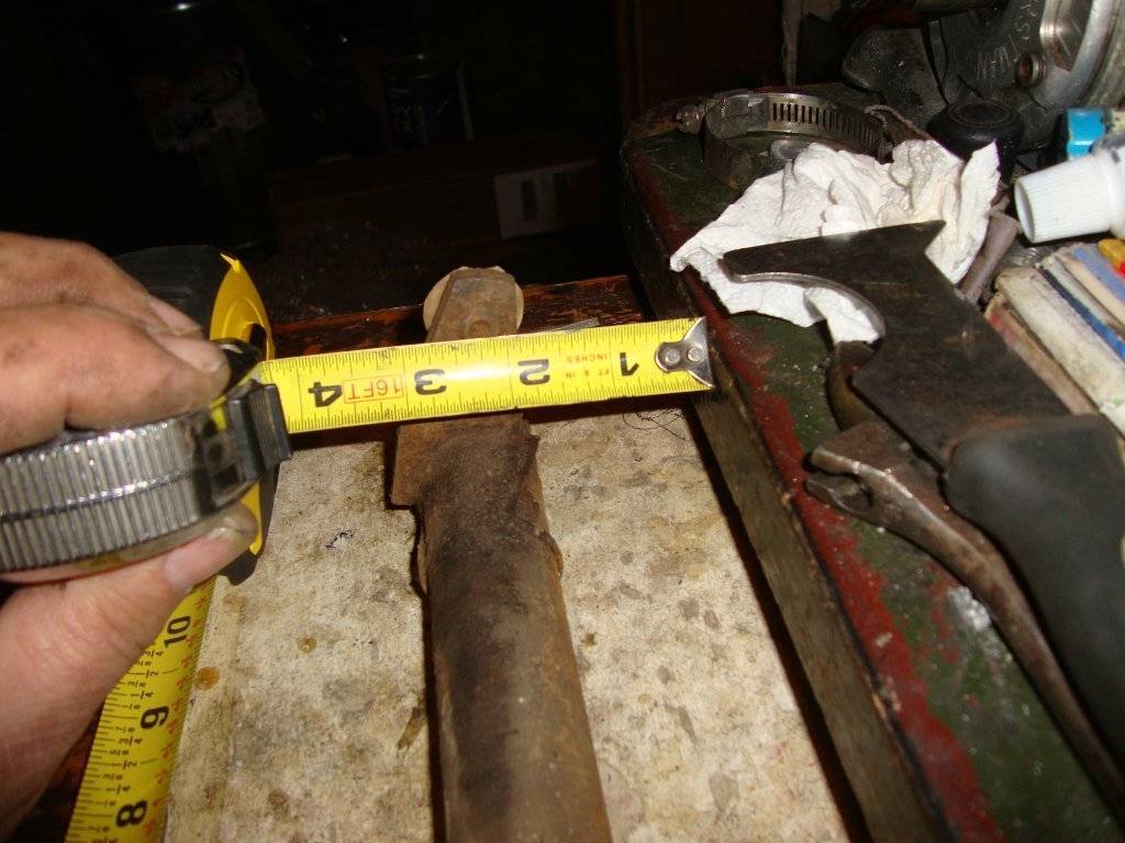

more pics of the z bar . you could piece it all together , i think the trans mount might be the same as the auto in 65 , but 66 started linkage to the 727 trans . the mounts are different location on the 65 has a cable on the tail stock for park as the 64 to 69 . were the mount is on the 66 up 727 , and 70 up a833 uses the same mount location . but a boidy a833 trans is 64 up , with the mount location as the 70 up a833 , pretty sure of this difference ,

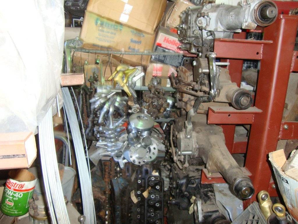

my a833 rack , it holds 12 a833's . and i've still got some laying on the floor to trip on . lol .
