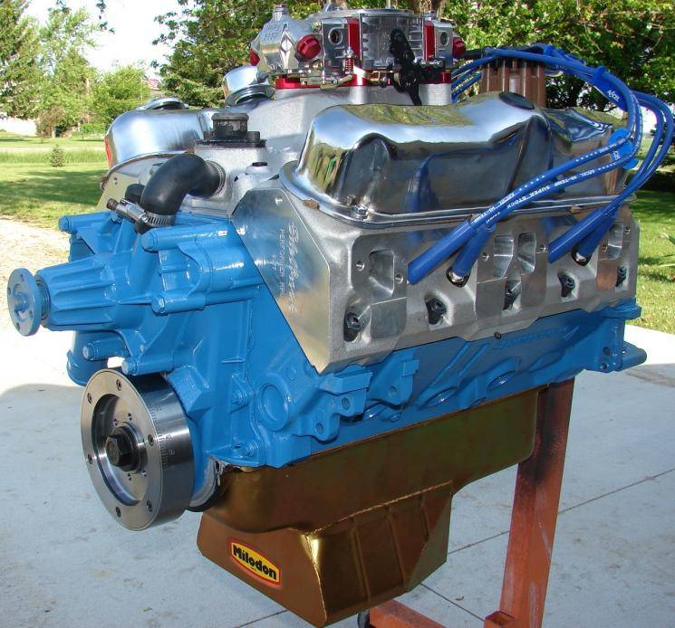

Here is the Skinny on this build:
340 block 4.080" bore 4.00" stroke
SCAT crank/rods
Icon 20.5cc dish pistons w/anti friction coated skirts, polished tops
Cam/rod/main bearings w/anti friction coating as well
Lunati Voodoo 60434 solid roller cam w/anti friction coated bearing journals
*NEW* MRL Solid Roller Lifters w/oil thru
Stage 2 MRL Ported RPM heads w/chamber mods
ARP head/main studs
Mr Gasket MLS head gaskets w/Lifetime Guarantee never to leak
Lunati Tool Steel retainer w/Lunati springs/locks/seals
Crower 3/8 pushrods
PRW Stainless steel roller rockers w/anti friction coated shafts and oil grooves
Milodon oil pan/pick-up
Throw back chrome MP valve covers
Holley Ultra HP 750 carb
Accel plugs/wires/separators
Pro Gear timing set w/tensionerWow what a freaking little power house.

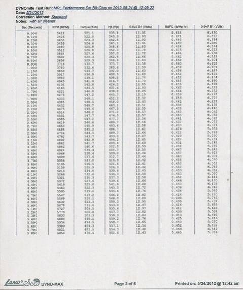

This 418 made 500tq+ from 3000-5800rpm maxing out at 548TQ from 4300-4500rpm
HP was 559hp at 5800-5900rpm It made 500hp+ from 4800 on up. Damn! Im proud of this one.
