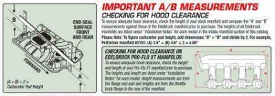

So I'm leaning towards the Edelbrock Performer carb, and it's making me think about the intake manifold. I'm thinking about getting a Performer manifold as well. One concern is the height of the carb and manifold combination. I read some (unconfirmed) reports of hood clearance issues on later Imperials.
Edelbrock lists the carb pad height of the Performer as 3.80" front/4.80" rear. Does anyone know the height of the stock 440 manifold?
That's a meaningless dimension. From where to where??
Two different manifolds will have two different base lines.
Like he said above, all you can compare is the DIFFERENCE on OAL installed height.
From the Edelbrock site:

Thanks. That's better than any other measurement I had gotten, which was none!
I'll grab some Plasticine and see how much clearance I have under the hood. Some of the other comments here make me think that I'll be sticking with a stock manifold.
