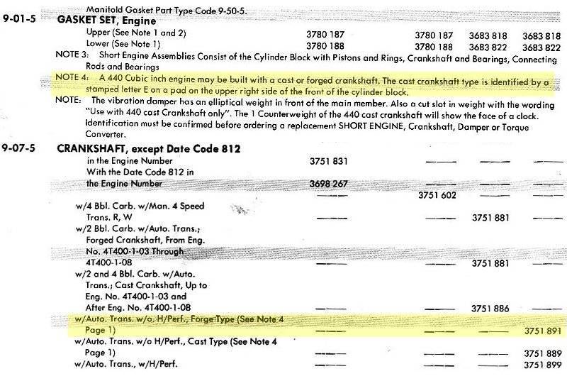

From the 74 parts book
There were many 440 passenger cars in 1973 with forged cranks, and any 400 or 440 with a manual transmission, even into 1978 was supposed to come with a forged crank

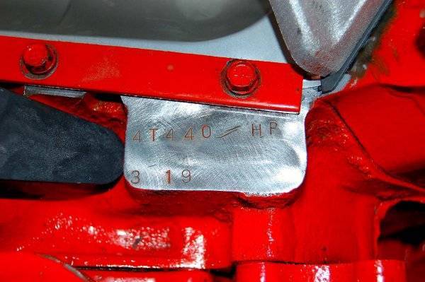

Forged cranks were standard in all 440 magnum engines thru 1974.I presently have one, from a 1974 Charger Rallye 440 magnum car. In addition, the crank was drilled for a manual transmission, and according to a very good Mopar Buddy, some manuals were built in 1974, despite the numbers saying none were built. I believe Chrysler was using up their supply of 440 engines, as by 1978 Iaccoca destroyed everything related to the 440.
All manual trans and 70 up to 74 HP have "6 pack rods" which were also in motor home 440s of this time should have the special vibration dampener, not the cast crank one. I'm sure there are standard rod engines out there also.
