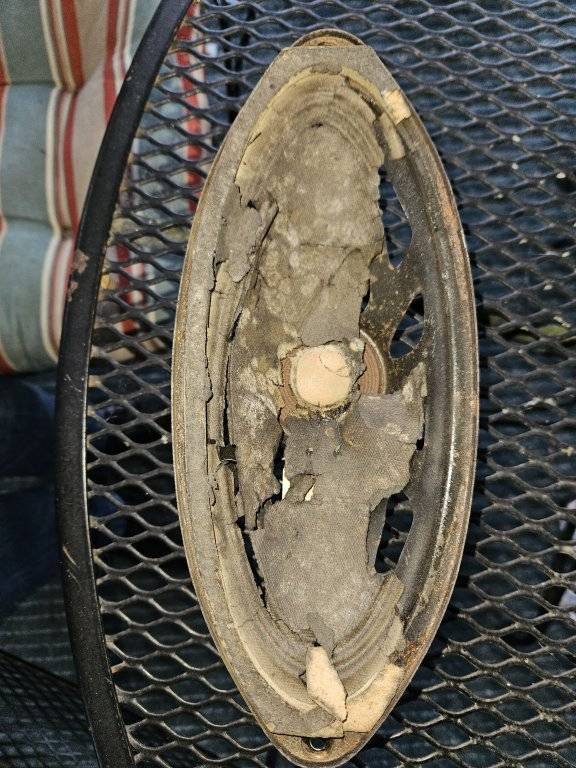

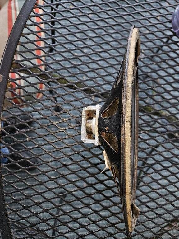

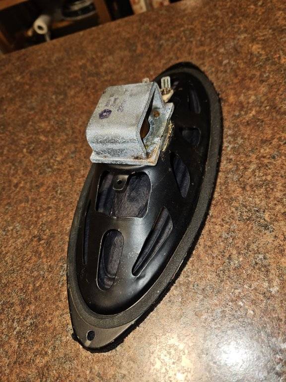

I need a source for an origional 4x10 speaker or a shop that can restore one. Later types or after market will not fit the dash.
Found a shop in Lafayette IN that will restore my speaker. I tried an after market speaker. The magnet interferes with instrument cluster.

Most of the current aftermarket speakers DO have magnets which are much too big for where they need to go in older vehicles. They are designed to handle waayy more power than the older radios could produce, so they have bigger magnets.

Im going back with the origional radio and speaker setup. The new yorker has 5 apeakers : 2 6x9s in the back, 2 3.5s in the front corners, and 1 4x10 in the center. Found replacement speakers for 4 of the 5. The 4x10 i thought would work was too big and as such the instrument cluster would not fit. Installed the origional radio wire harness which attaches all the speakers and the fader switch and crossover.

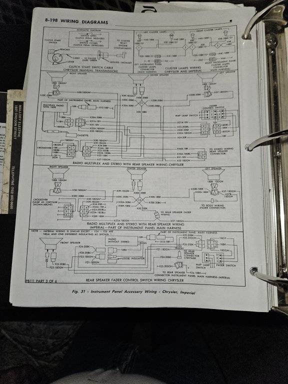

So what channel is the center speaker in the 3-speaker dash setup, then? Is it a left or right, or does it get a summed L+R?
The center channel is a combination of L and R, via the Clectron divider box. Just like the Sony tabletop radios of the earlier 1970s, with three speakers. "Matrix Stereo". AND the 1995 LH car's Inifinity-brand stereos. The center speaker can better do the lower frequencies as it is bigger than the front outboard speakers. A better sonic experience that GM and Ford could not do.
