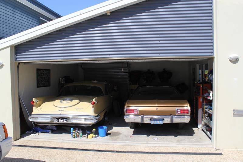

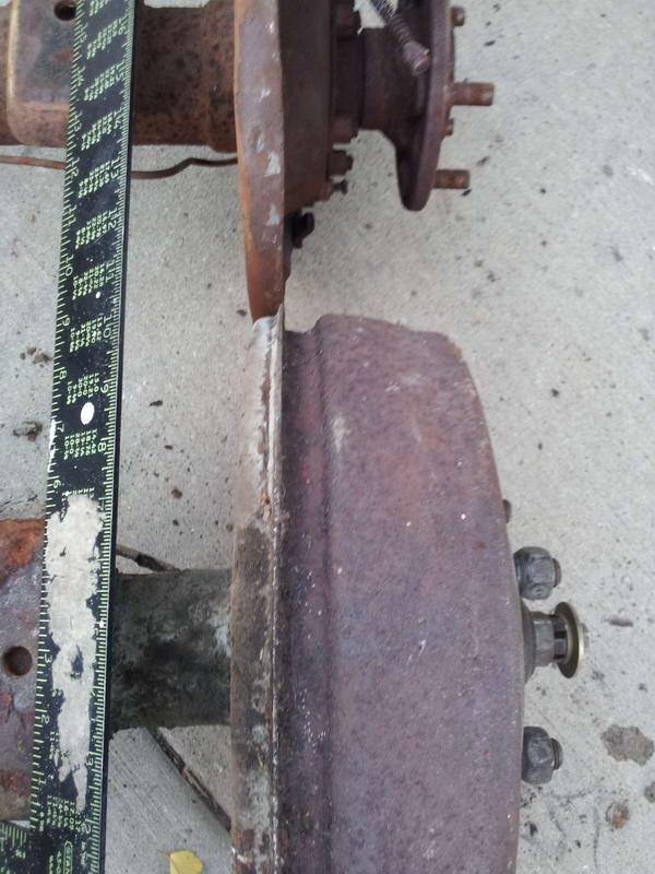

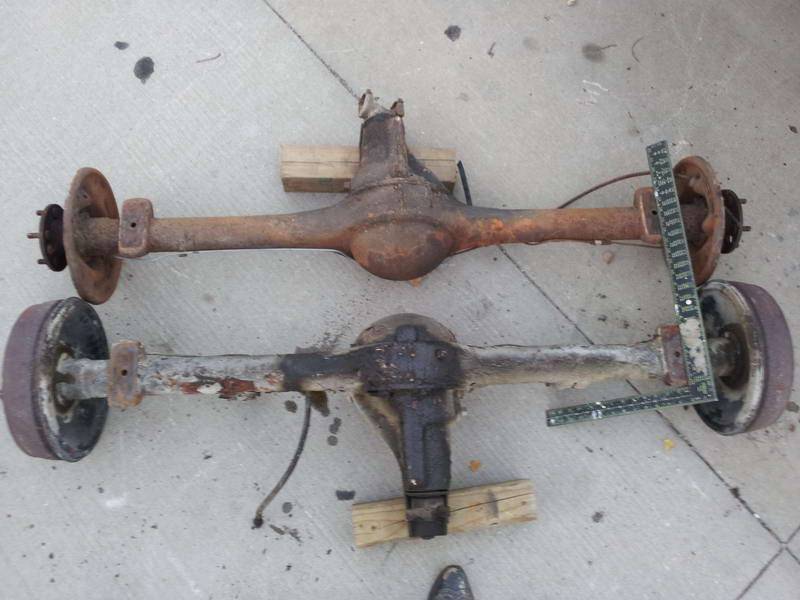

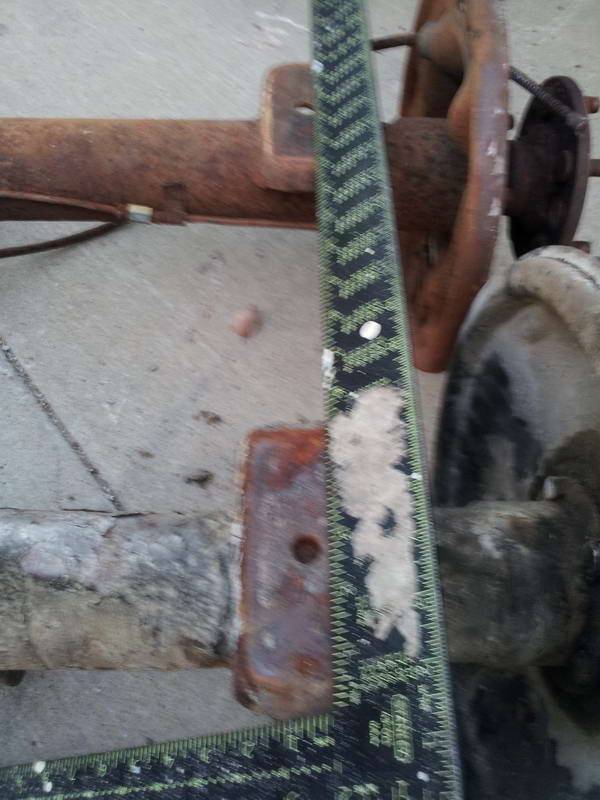

It is customary that new members post pictures of their car, (s), here. We are a very visual group.
