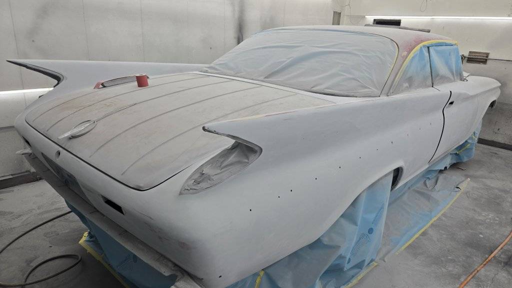

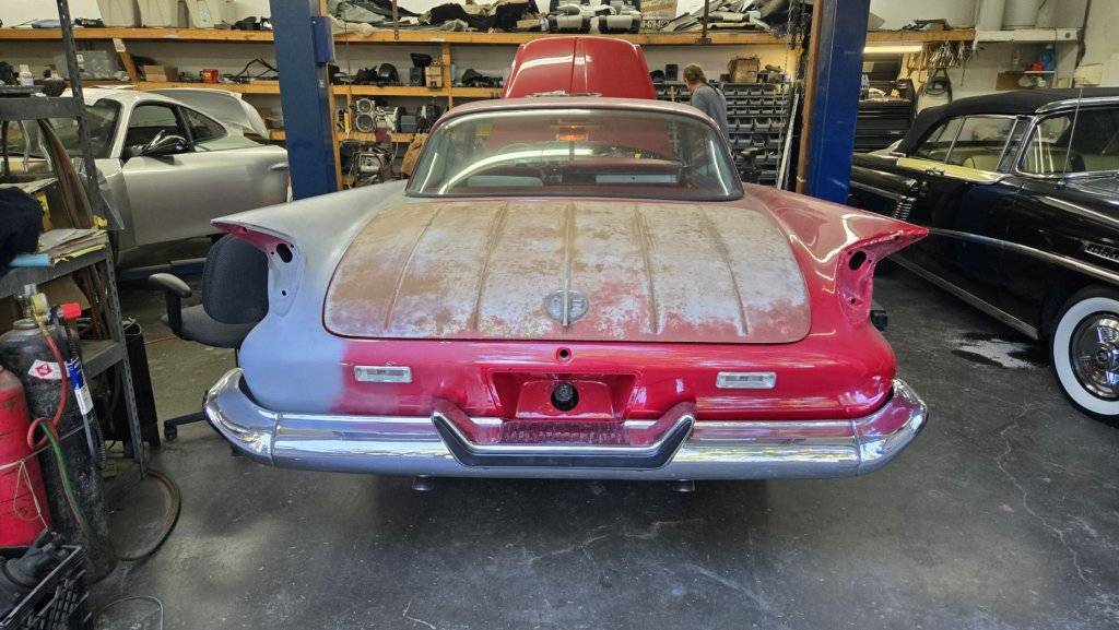

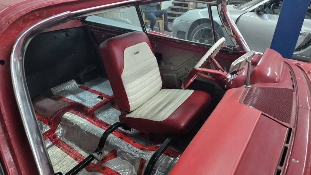

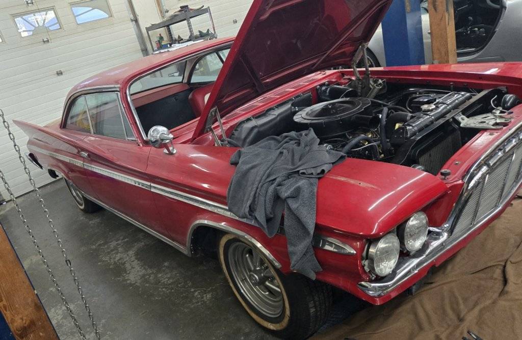

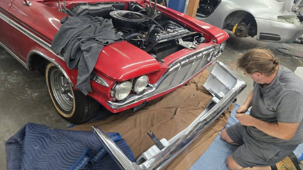

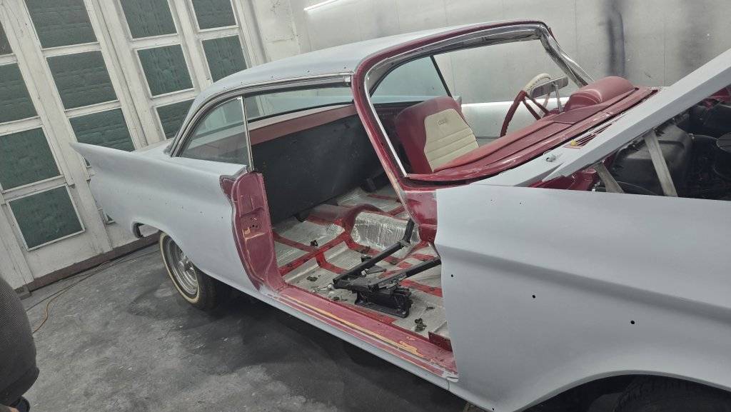

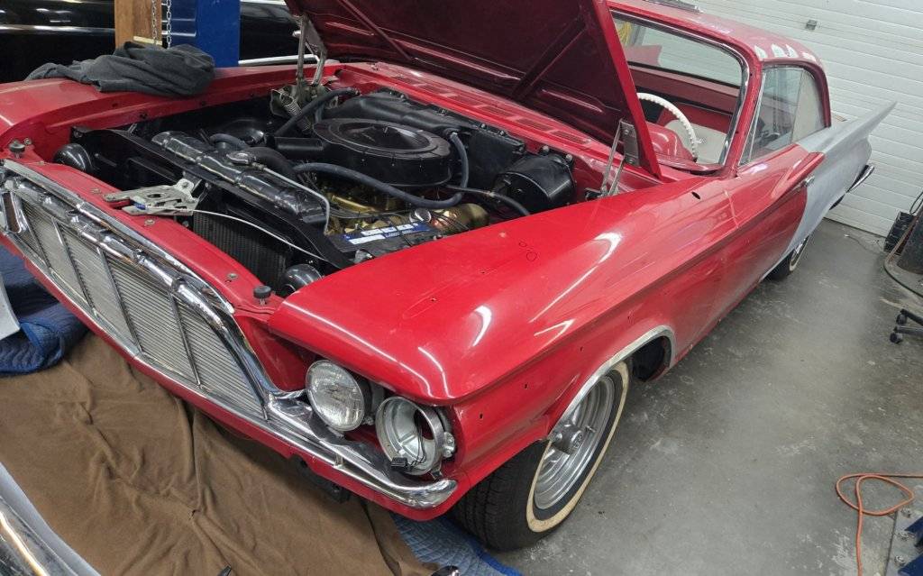

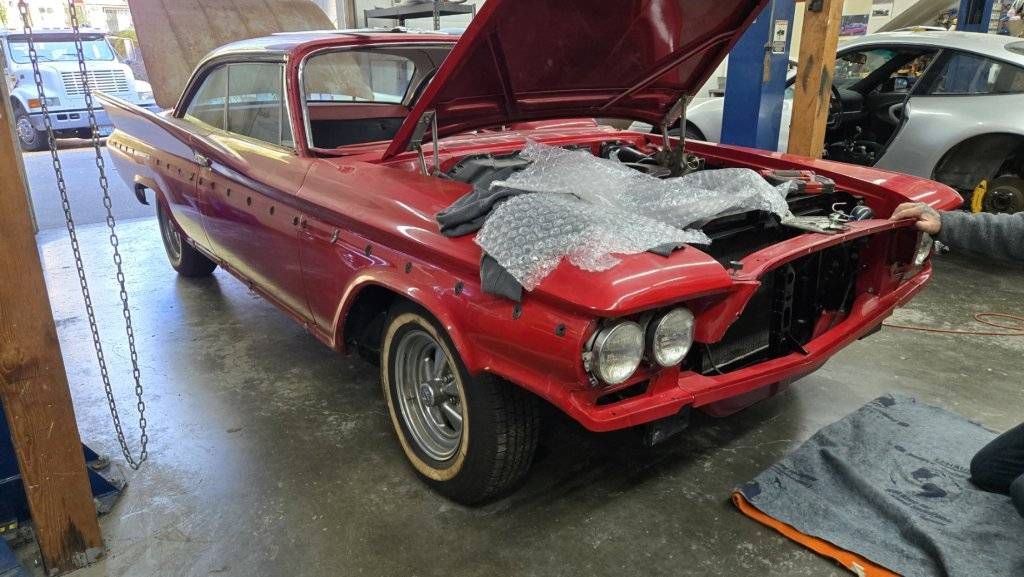

removing the trim on the 60 Desoto in preparation for the repaint...........
it will be painted a darker shade of red with a white roof. the existing paint has adhesion issues and is waaaaaaay too bright.

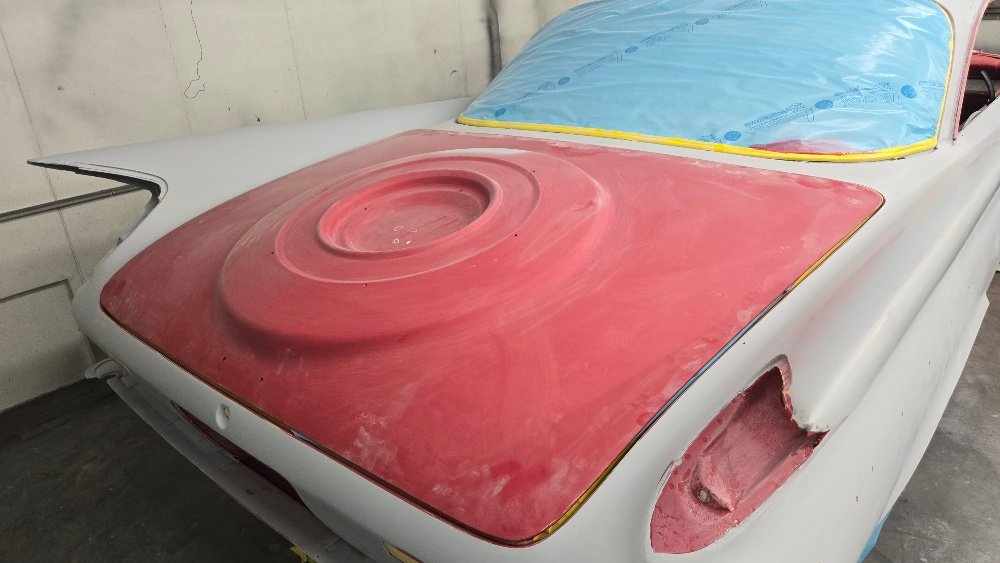

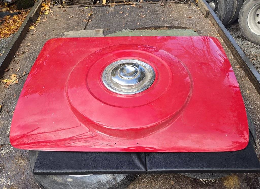

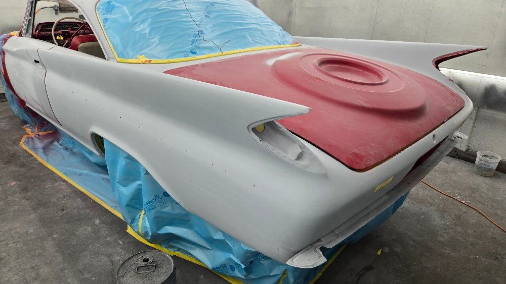

it will be getting a toilet seat trunk lid with white painted insert.
not sure about the cragars.......
Good looking car, nice to get that bright red gone from it.
I'd keep that beautiful pinstriped trunk lid, the toilet seat isn't that great. There a reason it's called a toilet seat!
thats actually a 1961 Chrysler trunk lid that we put on there to see how it looks, the lid we took off is bright red and rust free so it will go back on but its not the 1st choice. what sealed the deal is the trim has the Chrysler "C" on and theres no desoto equivalent badging that will work........

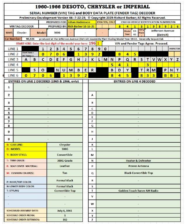

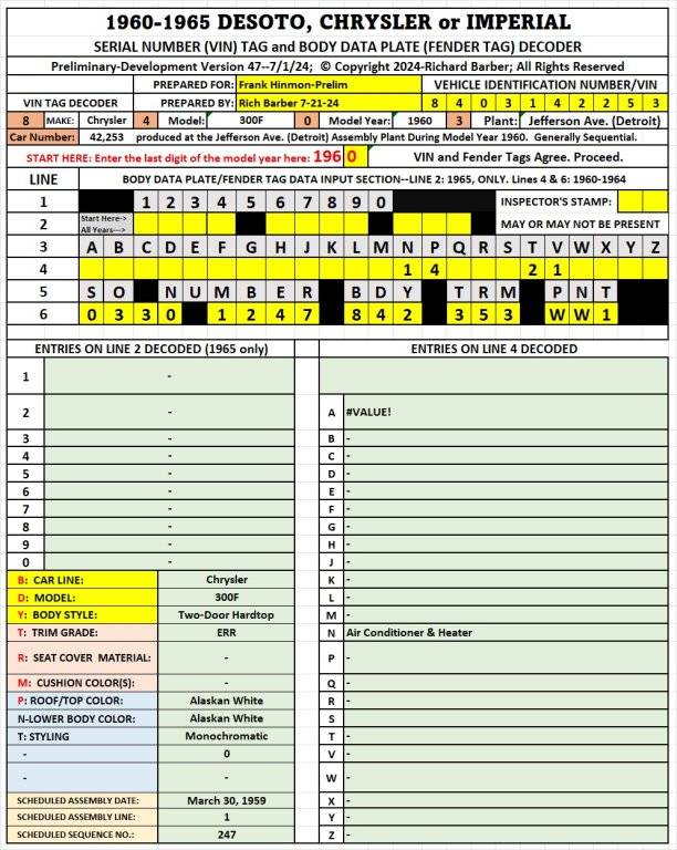

I could really learn from, appreciate and use a picture of this car's fender tag and, at least, the first four digits of the VIN. To assist me in the development of my free decoder to better cover the last of the DeSoto's. Sample attached. I will need your help in preparing the report as I believe '60 DeSoto's may have been assembled at two different plants. The fourth digit of the VIN will tell the story with mosst made at the Jefferson Ave. Detroit plant and some adventurer's made across the Detroit River at the Windsor, Ontario, Canada plant.

Please send the pic's and do retain the original parts of this rare and beautiful car. My DeSoto decoder is a passionate work in progress as is your restoration.

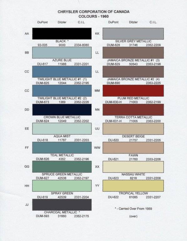

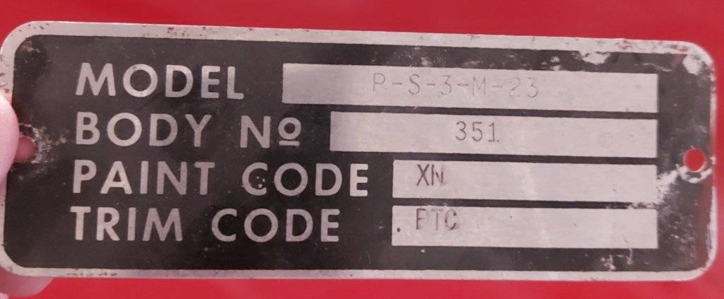

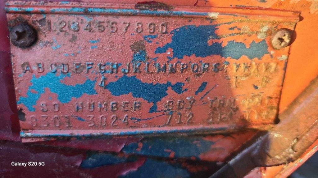

this car is canadian built. 1st 4 digits of vin are 72 091 ( the 72 is in larger font for what thats worth)
no other tag body aside from vin tag
and from Bill Watson :
1960 DeSoto -
N - Terra Cotta Metallic - Dtzler 71005
X - Nassau White - Ditzler 8218
The Terra Cotta (71005) was used only in 1960, and it seems to be only in Canada for 1960
PTC -
P - 1960
T - Interior Trim Colour - Terra Cotta
C - Body Style
Canadian 1960 DeSoto Adventurer used DeSoto instrument panel with Saratoga interior trim
1960 DeSoto -
PTC -
P - 1960
C - Body Style
Thank you. Pre '65 Canadian-built cars had minimal fender tags as compared to the tags of US built cars 1960 and onward. Examples of Fireflite and Adventurer tags are attached, The first four digits of your car's VIN: 7: DeSoto; 2: Adventurer; 0: Last digit of 1960 model year and 9: Windsor, Ontario, Canada assembly plant. Car #1 at that plant had a VIN of 100001. Wow--a red roof over a white body-spectacular.

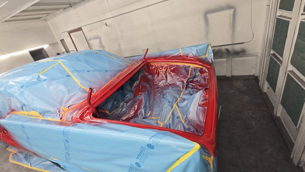

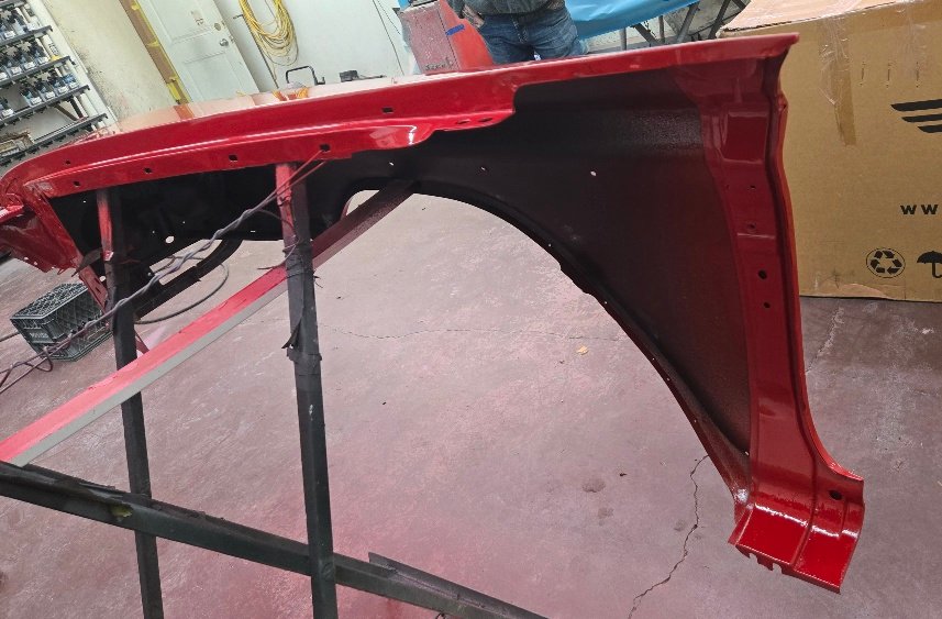

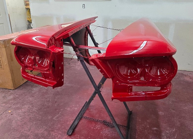

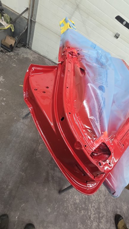

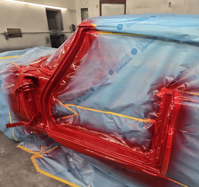

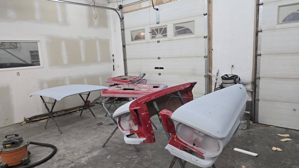

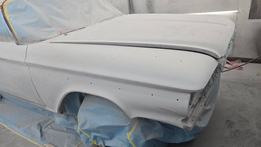

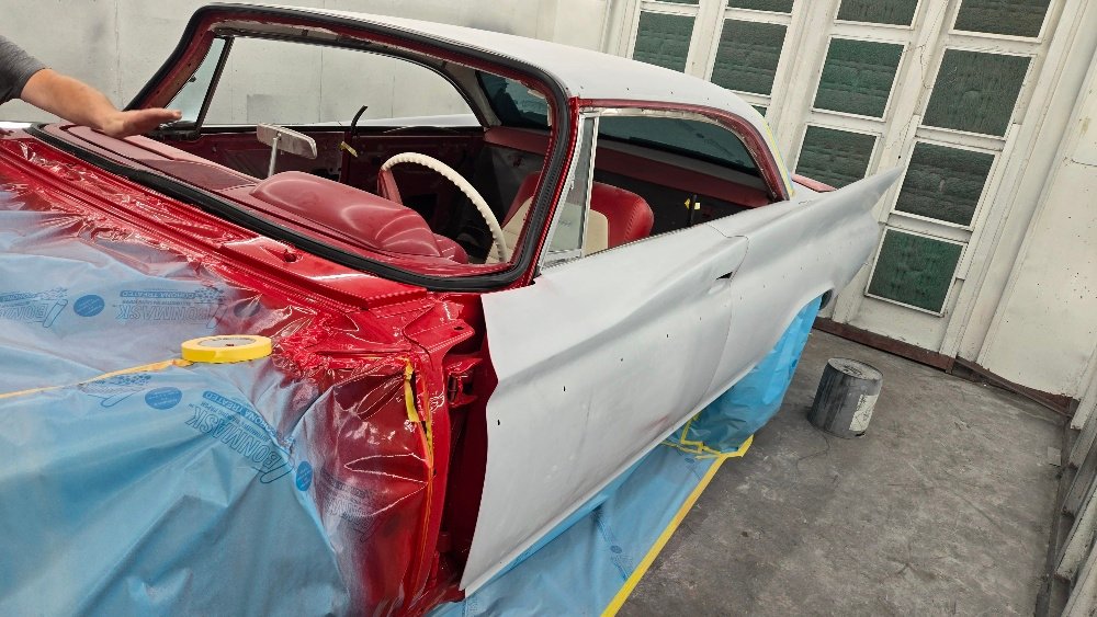

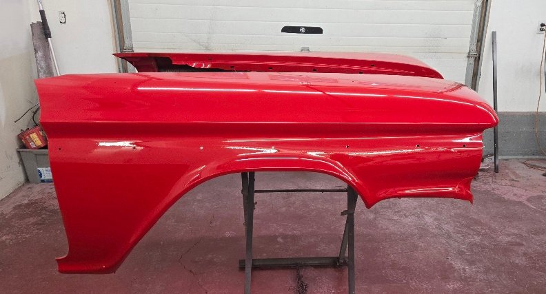

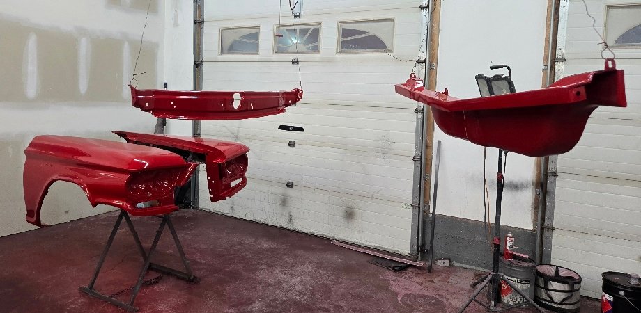

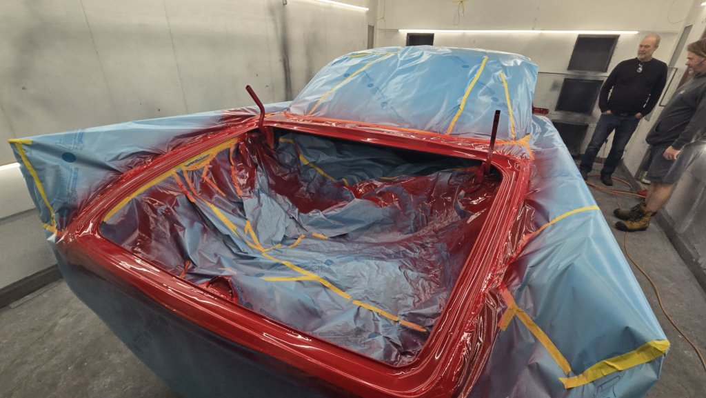

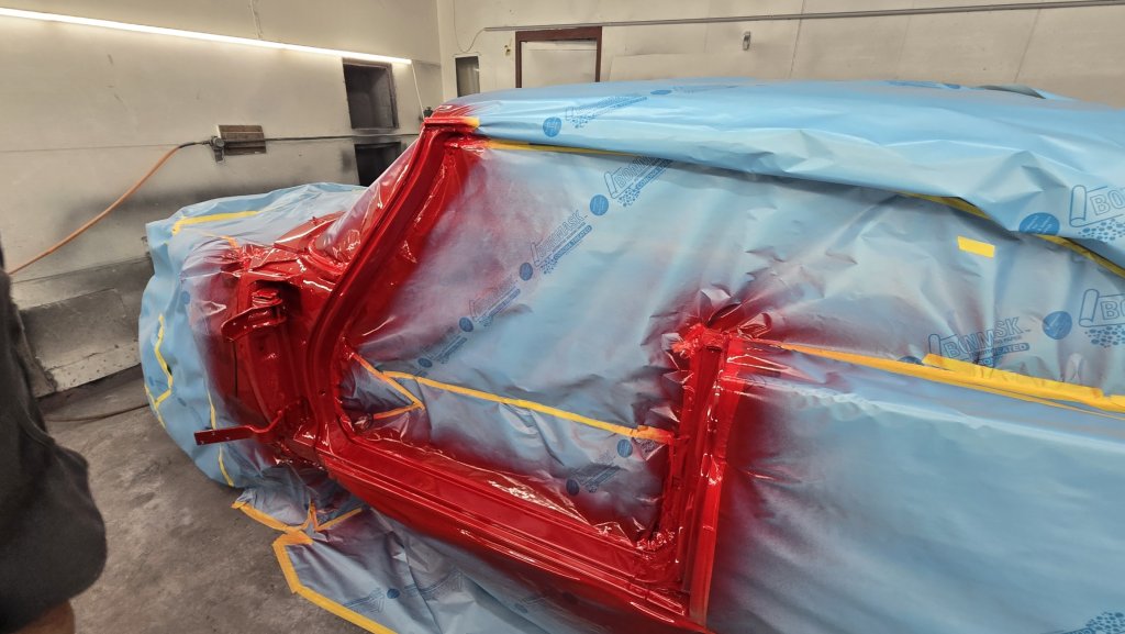

door jambs, door edges & underside of trunk painted and back on and getting adjusted.
body gets painted this week.
the roof and trunk lid toilet seat insert will be painted off white
