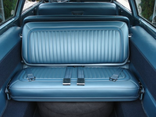

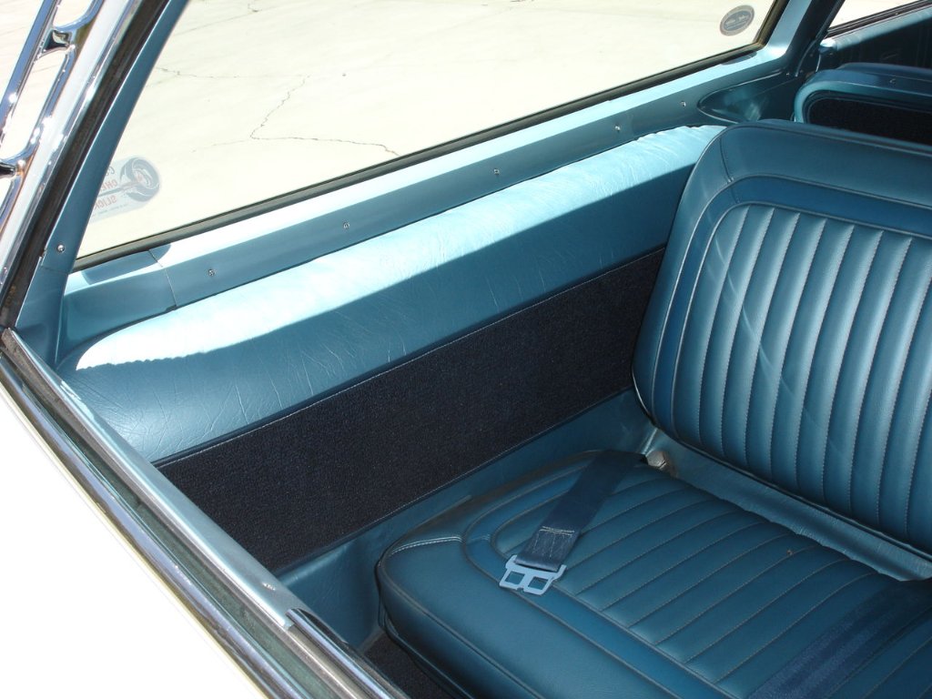

Quirey Quality Design Did make the headliner, chk with them. Did my 64. the wheel wells I covered in vinyl, and I put carpet inserts on the sides and floor.. SMS door panels, have a drink every time they miss their deadline. You might need a liver transplant.

Thanks guys, appreciate the info. There is a textured rubber insert under 2nd seat visible when you flip bottom cushion forward. Ill get some of that for the footwell. Probably have SMS do it.....I had them do doorpanels for my 65 Newport. Took forever so i know and the wagon is a project so waiting is ok. They've had the panels since June, also the linoleum type stuff for the cargo floor. Meanwhile i have plenty to do. Quiery has been a big help with weatherstripping, ill call about headliner.
My car does have a spare, anchors to tighten down is in footwell floor. Looks like tire slid under the seat. Also found what seems like a hold down for the jack under 2nd seat. Does that make since ? Where are your tires/bumper jacks ?
Don't think I can get the Captive Air tires anymore ! LOL. Did see those mentioned in the owners manual...
