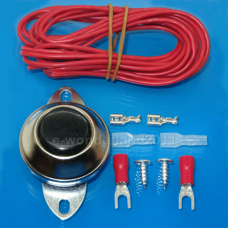

The easiest way is to add a horn button. One wire to ground and the other to the horn relay.
Of course, this won't work if the problem is your horn or the relay.
