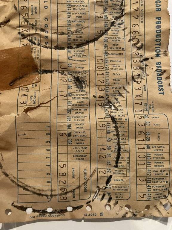

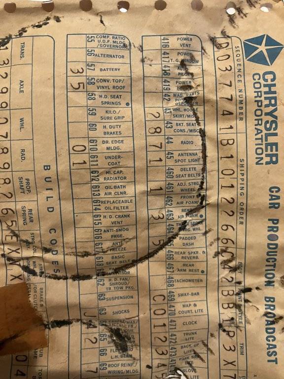

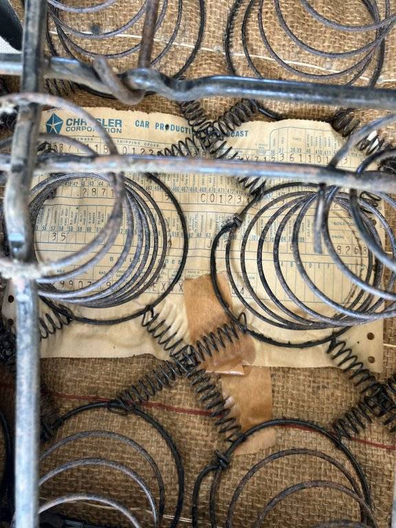

In working through the interior restoration of my 300L I was lucky to find the broadcast/build sheet in the upper right backseat springs. I know what some of the codes are, BB1 Paint and P3X and with the vinyl top code mean it’s a factory triple black. The guy I bought it from said it had a reverb but I found no evidence in the car/wiring and it’s not coded so that’s a nope. I’ve attached pics of the sheet. Any help or links would be appreciated. Before and after pics of the interior resto coming in the next couple of weeks.
Thanks 71036474965__46F0ED19-6418-4670-AA1A-DCC99869BED8.jpegIMG_0238.jpegIMG_0239.jpeg

Make a copy and put the original in a Manila envelope for safe keeping.
The numbers are:
Administrative such as the Sales Order number
Two or three digit Sales Codes I indicating what options or items thar come on the car. I.e. 365 automatic transmission 471 clock.
Build Code: two or three number indicating the last digits of a specific part number 89 or a complete assembly 299.
An additional source is needed to help decipher each section or number.

Thank you for the information.
