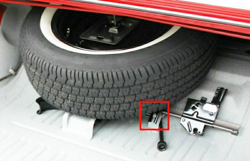

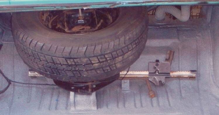

I believe the bumper hook gets mounted with the spare. The threaded rod should be long enough to go thru a lug hole and the small holes in sides of the hook. The wingnut then tightens down the hook and spare together.

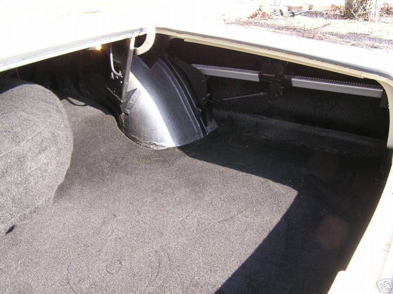

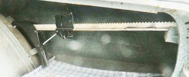

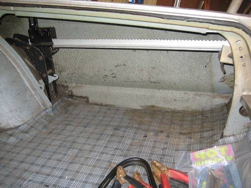

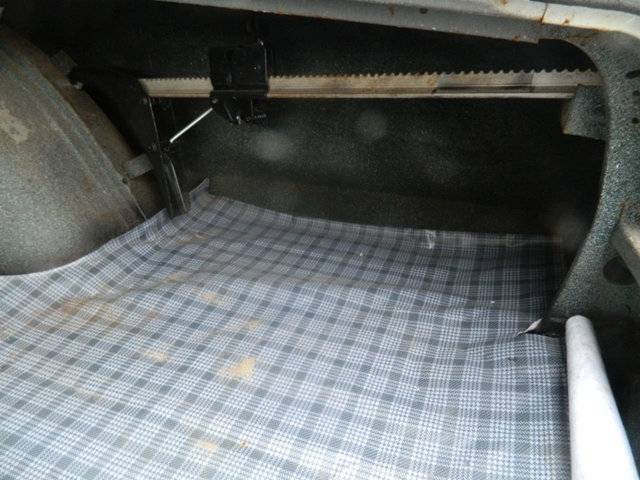

I found a couple that show the jack and hook storage.
Alan
I believe you are referring to the later style.
I "think" when the jack mast is quarter panel mounted as Alan's pictures show, the spare tire will be as your picture shows, except upside down. The threaded rod in the floor comes up through the center registration hole of the wheel, the jack base fits into that hole, also over the threaded rod, upside down and the jack hook fits over the threaded rod laying on its side, with the threaded rod through a hole in the side of the hook. Then the big wing nut is installed and clamps the whole mess to the floor.
Probably.
My jack is just loose in the trunk on the Monaco. Trunk is full of spare parts right now.
Looking at your photo. I have seen the bumper "hook" mounted right on top of the jack base then all tightened down with the big wingnut. Don't recall what models that was done in but it was a trimmed out trunk with a tire cover.
(What he just said better!)

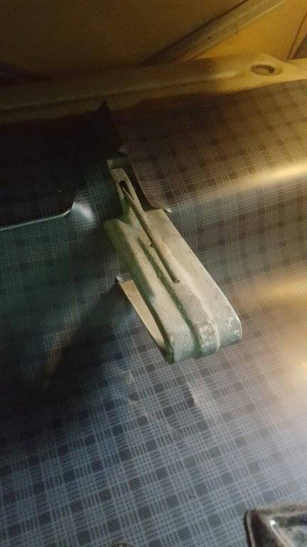

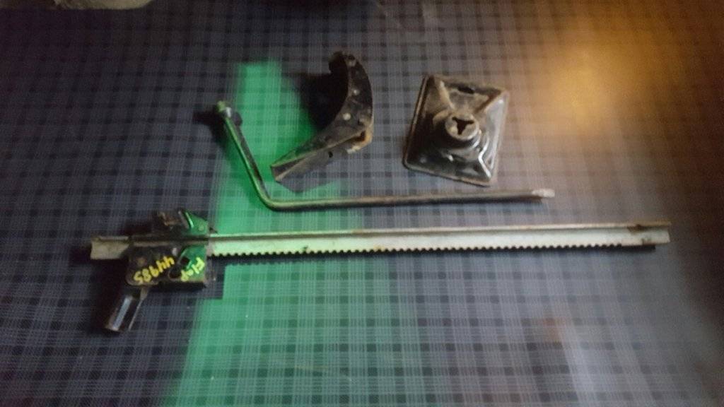

Here is what I've got for a jack. It's the same one pictured in one of Commando's posts above (later style?), although my car has no bracket to fasten the tire iron as shown in the same pic.
There does appear to be a bracket of sorts on the pass side wheel well as in MrMopar's post.
I've attached some pics to show what I've got.
I'm missing a wing nut, and I don't have a spare tire at the moment, but I'm pretty sure I can get one.

That pretty much looks like the correct era jack for your car. Make sure the part for the bumper fits well, last thing you want is the car to fall off it.

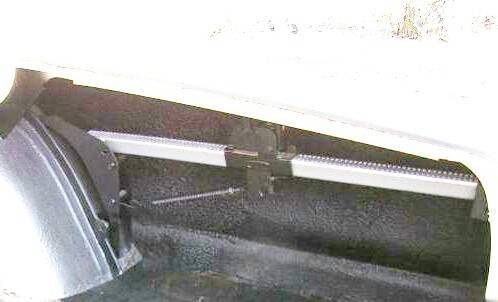

Here is a shot of my 65 Monaco. I am missing the hold-down spring. The spring will attach to the hook near the base of the wheel well and to the black ratcheting mechanism. The rachet thing will end up moving to the right and put tension on the spring to hold all tight. Crowbat gets wedged under tire and base goes over bolt to hold down spare.
Plymouth has the side fuel filler neck and it should look like this set-up.
