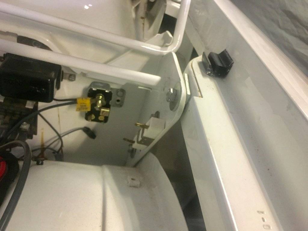

what model stops are ppl using on their 65 furies? I gather they don’t make the original ones
Terry, The rear hood bumpers like in your pic, are the same as used on the 64 & 5 B bodies. PN: 2317523 and 2445476. That is what I used on mine. The front bumpers are different. PN: 2524106. No one is reproducing them. I found a similar one and ground it down to fit mine but don't recall what is was for. I think I have a couple of the rear ones but would have to look. On your other post for the convertible boot drain, I think I have one of them too. Will do some searching.

Thank you for your reply. Definitely interested in the drain if you find one. Thanks for the info on the stops. Kind Regards Terry

Terry, I never did find the drain tubes. I know I had both that I removed from a 65 Fury III many years ago thinking mine were missing but they were not. I did find two of the rear hood bumpers though if you need them.

Thanks mate. I’ve picked up a couple of extra stops. But if you find the drain in the future I’d be interested. Thank you for your reply. Cheers Terry
