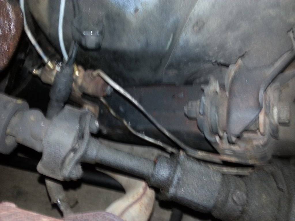

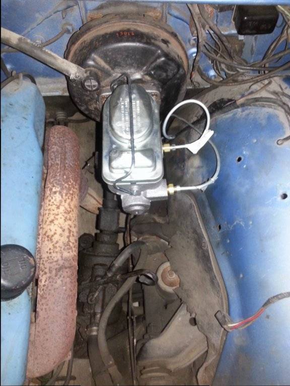

I have all the parts to do the conversion here or on order, so any day now. Anyhow I have a question, so I do not have to read through this whole thread again, so here goes; The block on my '65 that is fed by my single reservoir master cylinder is only a D/B or distribution block, and not a proportioning valve, whereas the donor '71 Block is an actual P/V, or Proportioning Valve, right?
Reason I ask Is I do not want to mess up the brake lines, so if I can just get the rear feed line off (without damage) and plug that hole then I can leave the front lines on the original block and feed it from P/V via the new M/C, while feeding the rear as per normal directly from the P/V. Your thoughts? Best way to get the lines off without destroying them?
