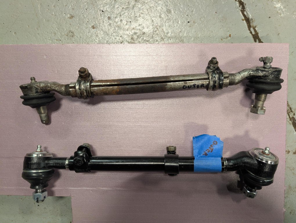

I just started working on my 1965 Chrysler New Yorker. My Dad had one of these when I was young and that's what I learned to drive in. So, when I saw this one for sale in the Northeast and it wasn't a complete rust bucket, I had to buy it. It's straight, body and frame aren't rusted, all 4-power windows work, power antenna works, cigar lighters work, all lights, horn, radio work. Overall, it's in incredibly good shape for being 60 years old.
So, onto my dilemma. A lot of the suspension, steering boots and bushings were dry rotted so I started there. I bought a complete front end suspension kit from A-Resto Parts. The tie rod ends on the car have an offset on both the inner and outer. They look identical except one has right hand threads and one is left hand threads. The ones I got from A-Resto have an offset on the outer, but the inner one is straight. Everywhere I looked, Rockauto, Kanter, etc., the part #s are the same as what I got from A-Resto. So, I think they're right.
Has anyone come across this? I'm not sure what will be affected if I use the ones from A-Resto.
