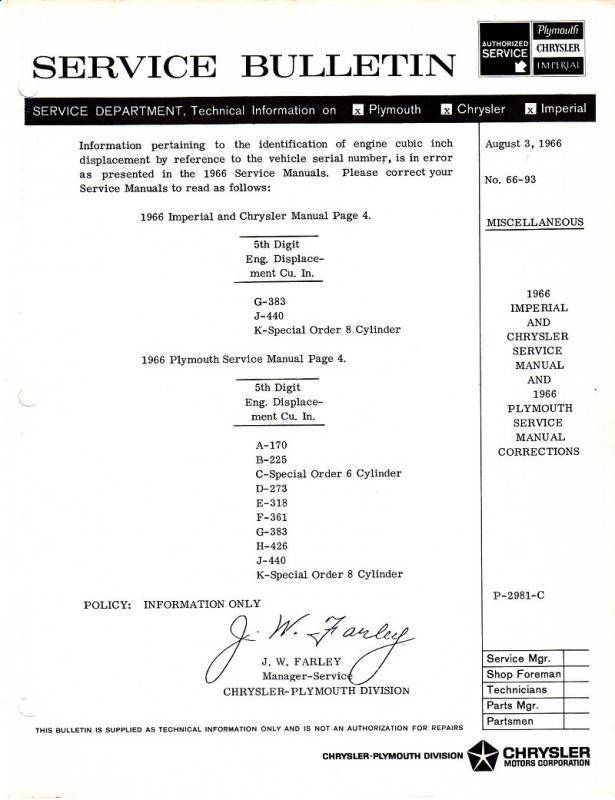

I'm doing some scanning for HH (Some nice items coming) and came across this 66 C-P-I Technical Service Bulletin (TSB) correcting the '66 C-P-I FSMs on VIN codes.
I was reminded of this thread: http://www.forcbodiesonly.com/mopar-forum/showthread.php?18990-VIN-question&highlight=1966
So...here's the factory correction to the FSM. I have a PDF file too if anyone would like a larger copy for their files. Send me your e-mail address via PM and I'll forward a copy to you
