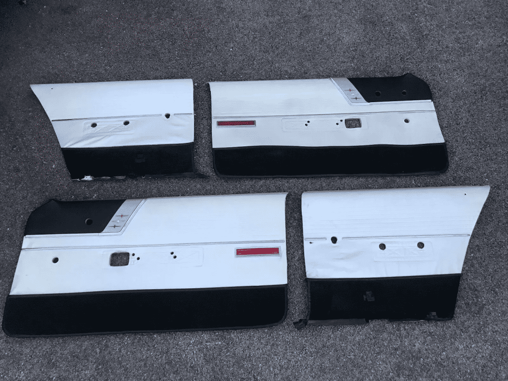

I decided to quit hoping I'd ever hear from SMS about new door panels for my '66 300 convertible, so I engaged a local trim shop to make them for me. All is going well, but the reflector lenses attached at back edge of the panels are a problem. The attaching studs are crumbling and they are not long enough. Does anyone make a repop lens with the metal that surrounds the lenses? Here is a photo of a '66 door panel with all the trim intact:

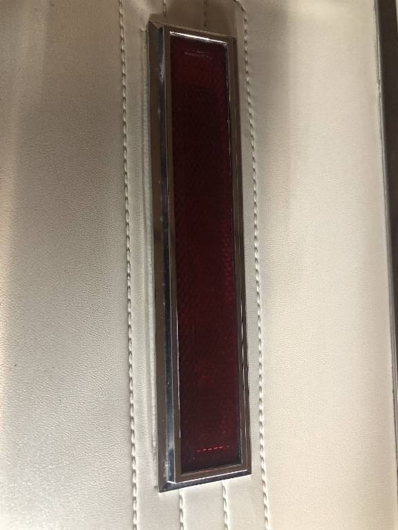

A pic of my '65 door panel reflector. Some unknown previous owner cut an opening and installed a light behind it. It was a fire waiting to happen, so it's been tossed, but that's a story for another thread.

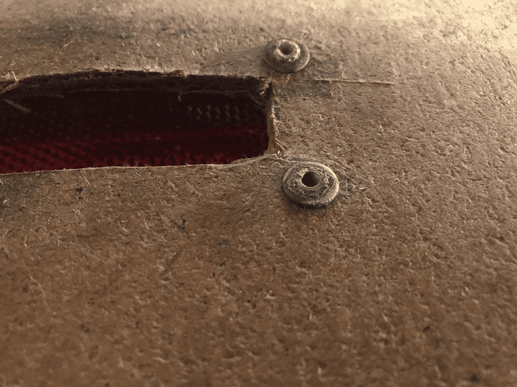

I can't believe they riveted the lens directly to that material (fiber board?) without so much as a steel washer or anything for backing . . .
There are washers. Look closer. The top hole shows it better.
The washers are put in place and then the studs are mushroomed.

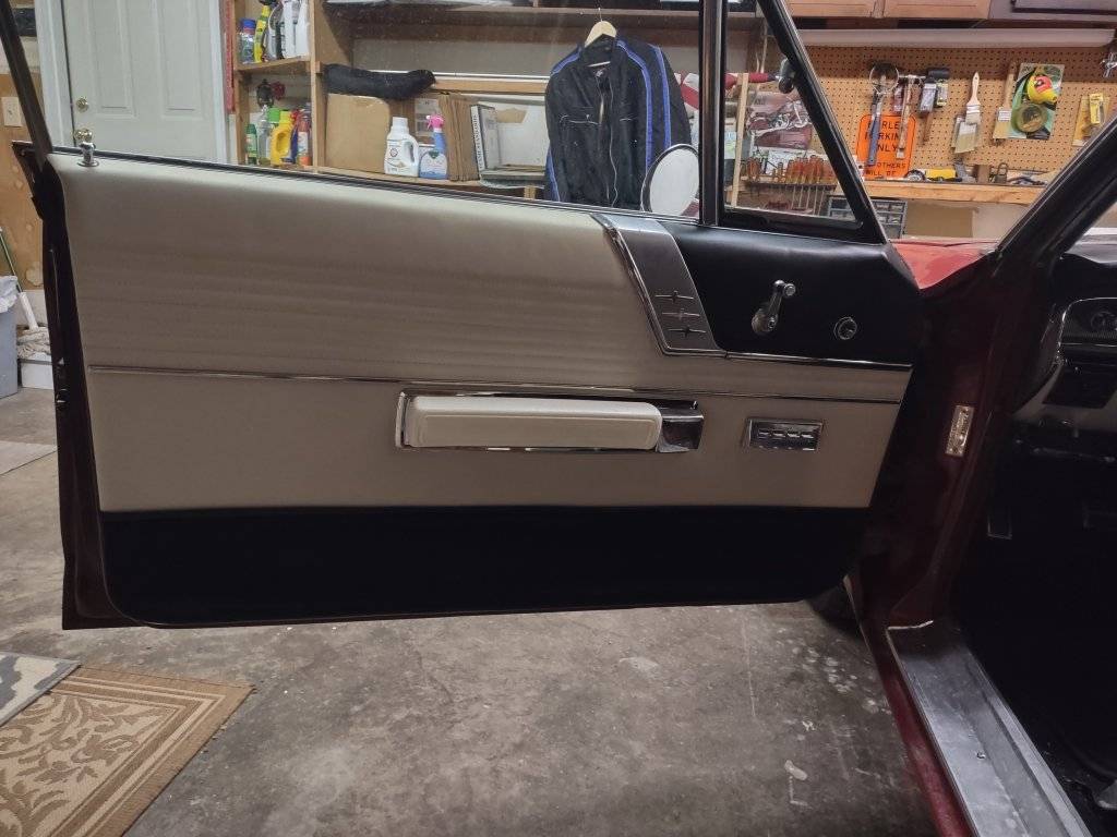

Thanks again to everyone for the suggestions. I finally pulled the trigger to eliminate the reflectors altogether. Here is shot of the new driver door panel:
